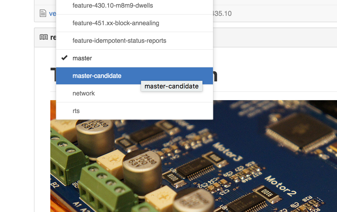

I built the master candidate release today. I am hoping one of you might have some time to kick it around. Its basically edge but with some more optimizations / fixes. Any takers? I will email you the link if you want to. I don’t want to post links to pre-released files on the community. Shoot me a comment or msg me @Riley_Porter .
