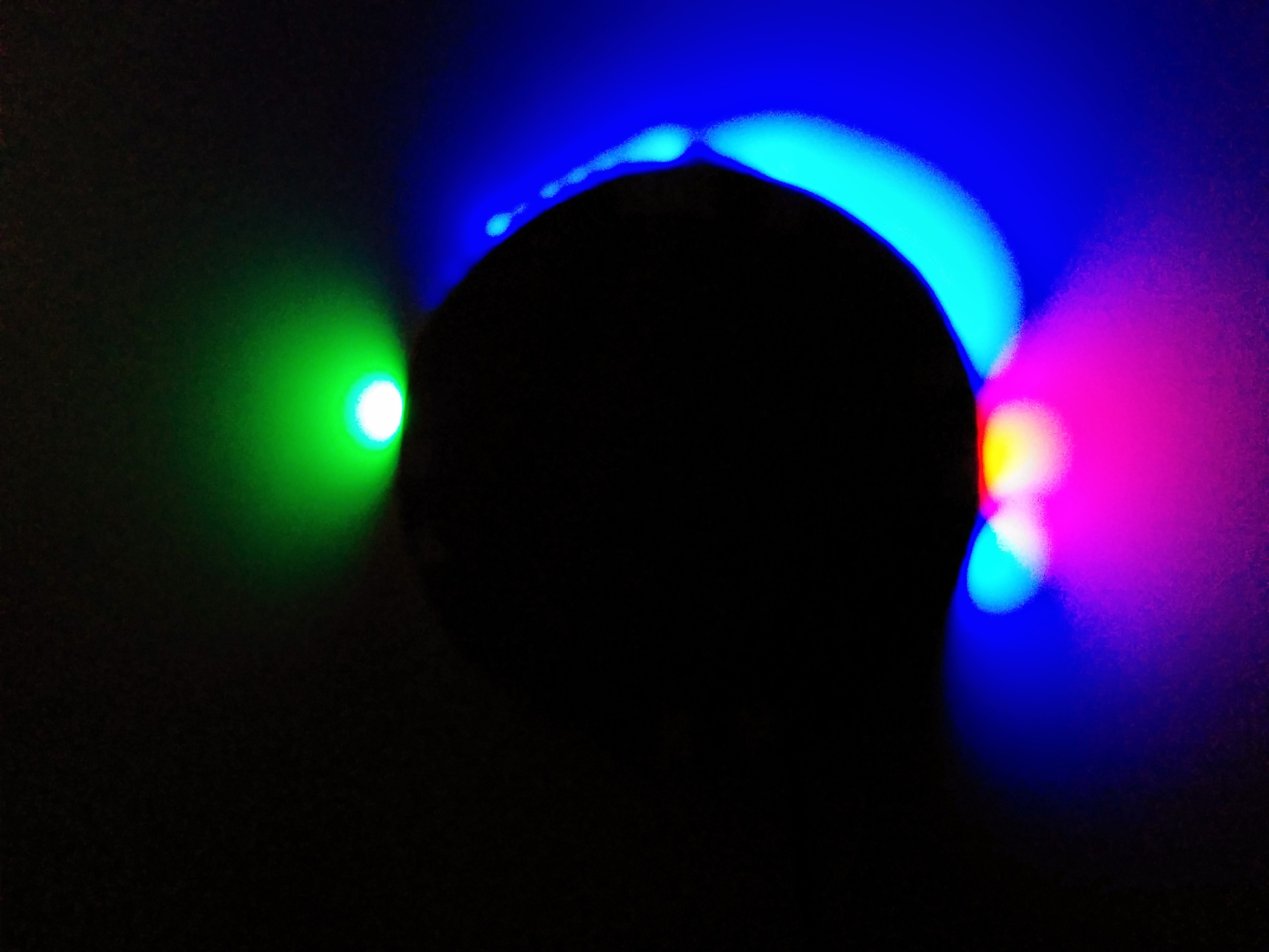

I built these prototypes out of cardboard a while back,
I built these prototypes out of cardboard a while back, and have been waiting to share them until I built proper bodies out of wood (which still hasn’t happened). Built three different sizes, each with 60 APA102s: 5.22" small (144/m), 10.44" medium (72/m), and 12.53" large (60/m). I plan to build them with larger faces to block more direct lighting. They diffuse very nicely out onto the wall on which they’re hung.
I really need to step up my woodworking skills, so I found a local guild that has all the expensive equipment, and classes to learn how to use them. Now I just need more spare time… :slight_smile:

Clock/circular display built with a Spark Core, syncs time automatically via Wi-Fi. All you have to do is set the time zone.

I’m a big fan of the light spreading onto the wall thing - https://www.youtube.com/watch?v=6RKPT5N-2zo
And an even older, cruder one (from the FastSPI_LED days with the LPD6803 chipset) - https://www.youtube.com/watch?v=ePdzfv3fUGA
I love the looping spirals on yours, Daniel!
Thanks, JP! I admit I thought of you when I decided to go ahead and post these. As always, I’m looking forward to seeing how you handle the physical construction (something I struggle with every time). :slight_smile:

Now I have to admit that I was initially thinking of something similar, in wood to use as a cover instead of cardboard but now that I saw that video, I do not think any solid round wood faceplate would be best here.
I’ll give this a bit more thought and come back with any ideas if they come.
Wondering about what a simple thin, opaque disk painted to the exact wall color would look like !?
It would probably be better to have it be a wider diameter than the actual LED to hide any direct view of them.
I would also drill a hole in that wall and hide any wires coming out that assembly.

@JP_Roy , yeah, I plan to hollow it out and mount the electronics inside, and definitely increase the diameter of the face to hide direct view. I’ve debated what to put on the face, if anything. Ideas I’ve thought about:
  • Matching wall paint color. I like this idea the most, because it’s the light that matters, not the physical form of the device. This would let it ‘melt’ into the wall.
  • Moar LEDS! Like Daniel’s clock, why limit yourself to light diffusing on the wall? :slight_smile:
  • A clock face. This seemed the most obvious, especially if actually telling time is a priority.
  • Sports logo, movie, comic book, poster, photo etc. A clear acrylic face where you can place whatever you want.
  • Shadow box. Just make it clear and hollow, and fill it with whatever. Hide the electronics behind a back panel.

I’ve searched for pre-cut circles of wood and other material, but never find the right diameter. The diameter has to be just right for seamless, evenly-spaced light.
@Jason_Coon
All good ideas but with all due respect to Daniel, in this case, I think more is actually less… a simple, pure design would be more attractive in this case (IMHO).
If you go ahead and do it, consider a way to clip the faceplate on a mounted frame that holds the LEDS. It gives the advantage of being able to just change the faceplate if you are not 100% happy with your original idea !
