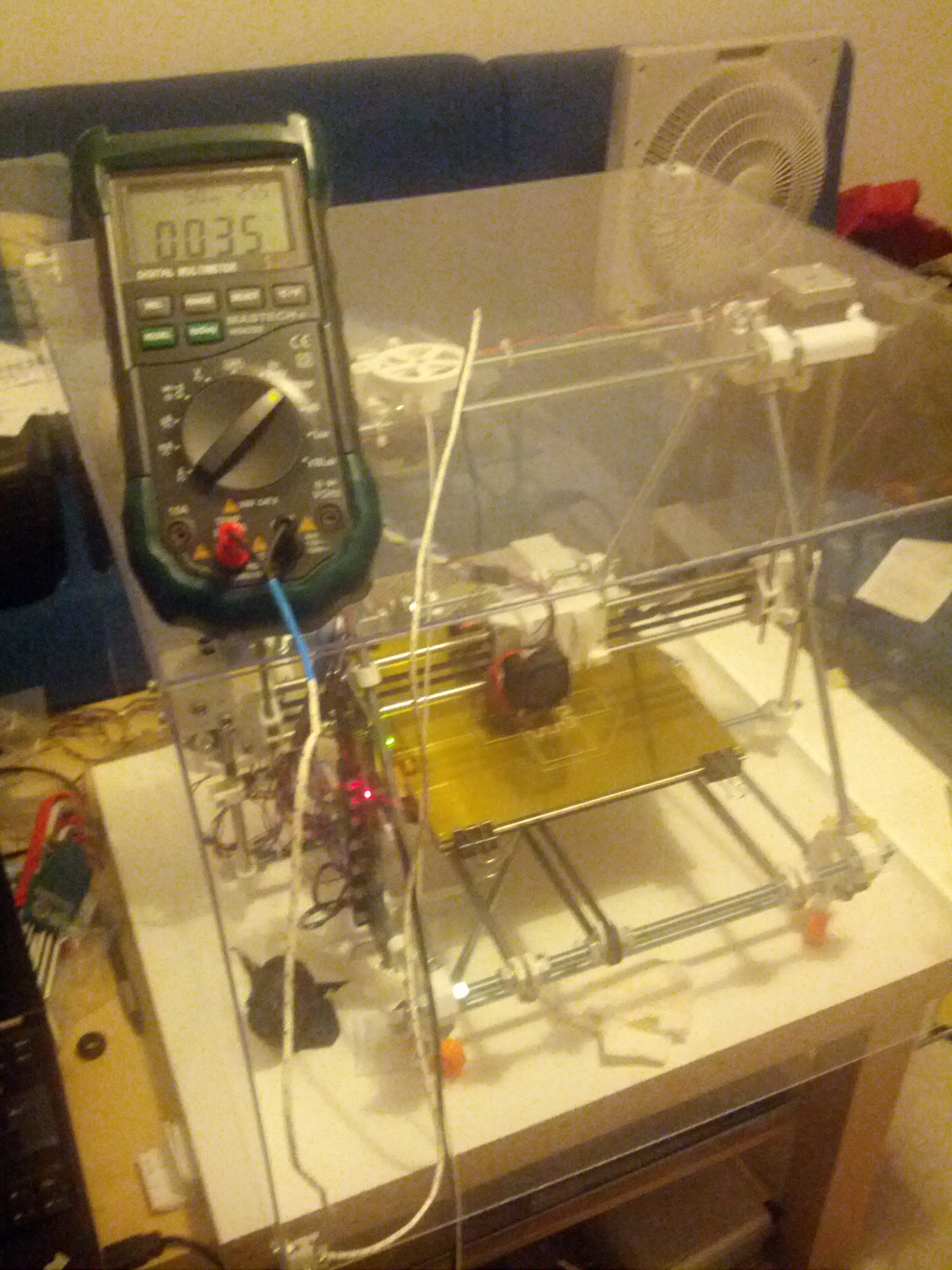

I built this yesterday Originally shared by Daniel Schulte Yesterday I built a case
Yesterday I built a case for my printer from acrylic to reduce the heating time when printing ABS and also not heating the room when printing. The corner brackets are printed from ABS as well.
At the top I drilled a hole to measure the air temperature with my multimeter. At the moment I am feeding the filament from the bottom, as I have nothing to use as a Bowden tube to get it through the acrylic without bending it to much.
I am currently planning version 2 which will be made with wood as this version is rather floppy and not as stable as I would like.

@Wayne_Friedt I guess you mean how hard it is to keep the printer square. It was relatively easy as I had a laser cut ruler with indentations at the required lengths so I just had to use that to square the frame. I also used a square to keep the angles orthogonal.
@3dpod_3D_Printing_Se My platform is heated, it’s a “normal” PCB heater with an aluminium heat spreader on top and on top of that is a glass plate with kapton tape for printing on

@3dpod_3D_Printing_Se After about 2 hours of the bed heater nearly being constanly on the interior temperature stabilised at about 40°C. If you are concerned about it getting too hot you could try adding a slow moving fan (120 mm maybe) and lead a small gap between the floor and the enclosure so the air can circulate but not cool off too much. Notice the gap where the case meets the table in the picture.
