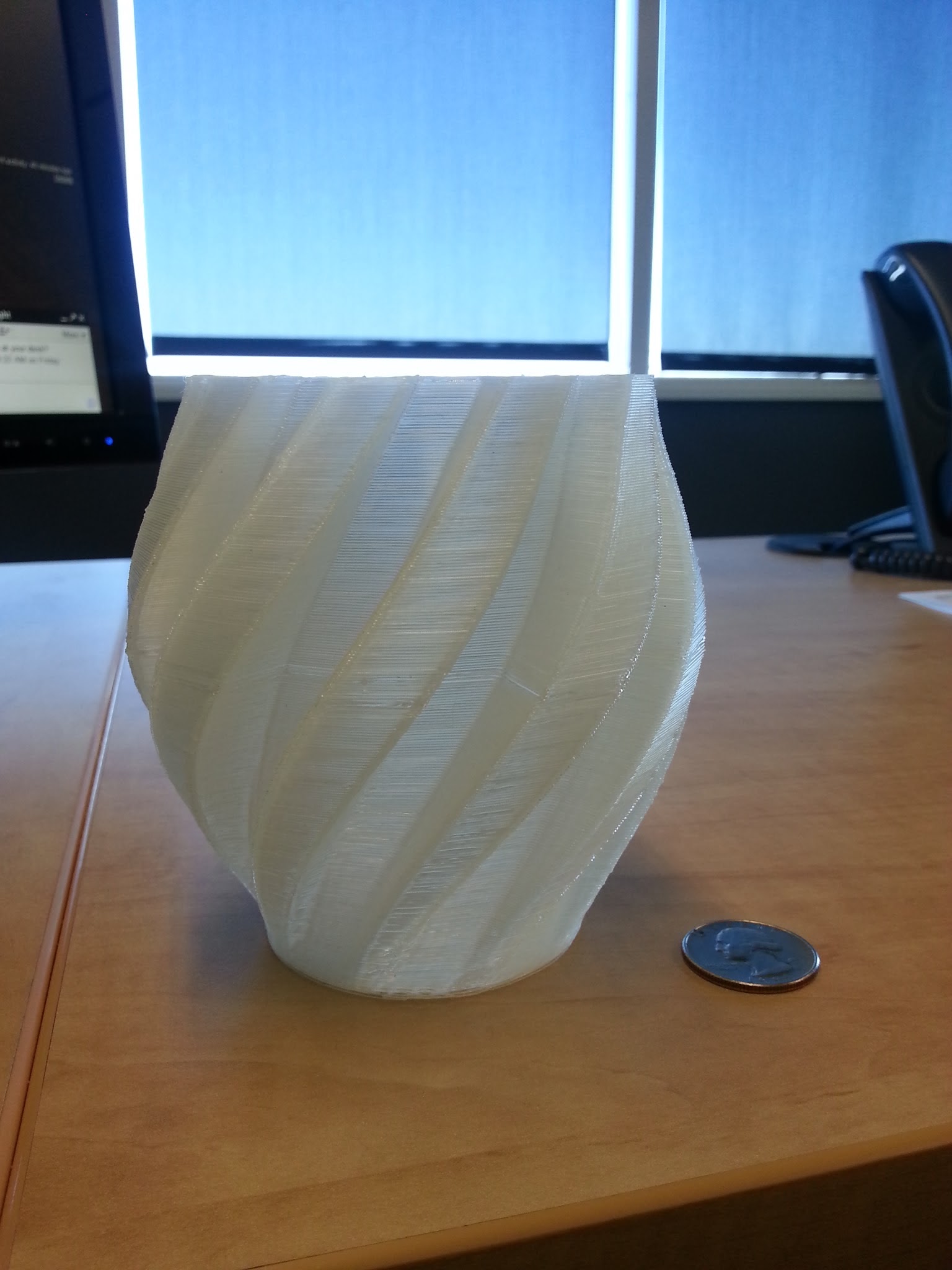

I calibrated my extruder (apparently that makes a difference :p Went from 569 to
I calibrated my extruder (apparently that makes a difference :stuck_out_tongue: Went from 569 to 519, thanks @Alberto_Valero_Gomez ) and extruded at 195 degrees (thanks @Nils_Hitze ). Aside from a filament snarl issue about 3/5 through the print (http://www.thingiverse.com/thing:31722), I think it turned out fairly nice. Still a lot of room for improvement, but I’m feeling good for my second day of printing on my Printrbot Jr!
I agree @Jeff_Karpinski . I’m going to spend tonight further calibrating it, as well as trying to tweak it for speed :slight_smile: The vase/lamp took around 3 hours at 0.4mm layer height and walls 3 layers thick, I know the Jr. is capable of printing faster than that, just need to figure out how to get there!
What filament did you use? My prusa can make a lot better quality but only with the right filament. I found faberdashery giving me the best results.
Just the stuff that came with the Jr, (http://printrbot.com/shop/1lb-1-75mm-pla/). I just placed an order for some PLA and Nylon filament from MatterHackers since they offer free shipping in the US. I’m hoping that will be here next week so I can play with it.
