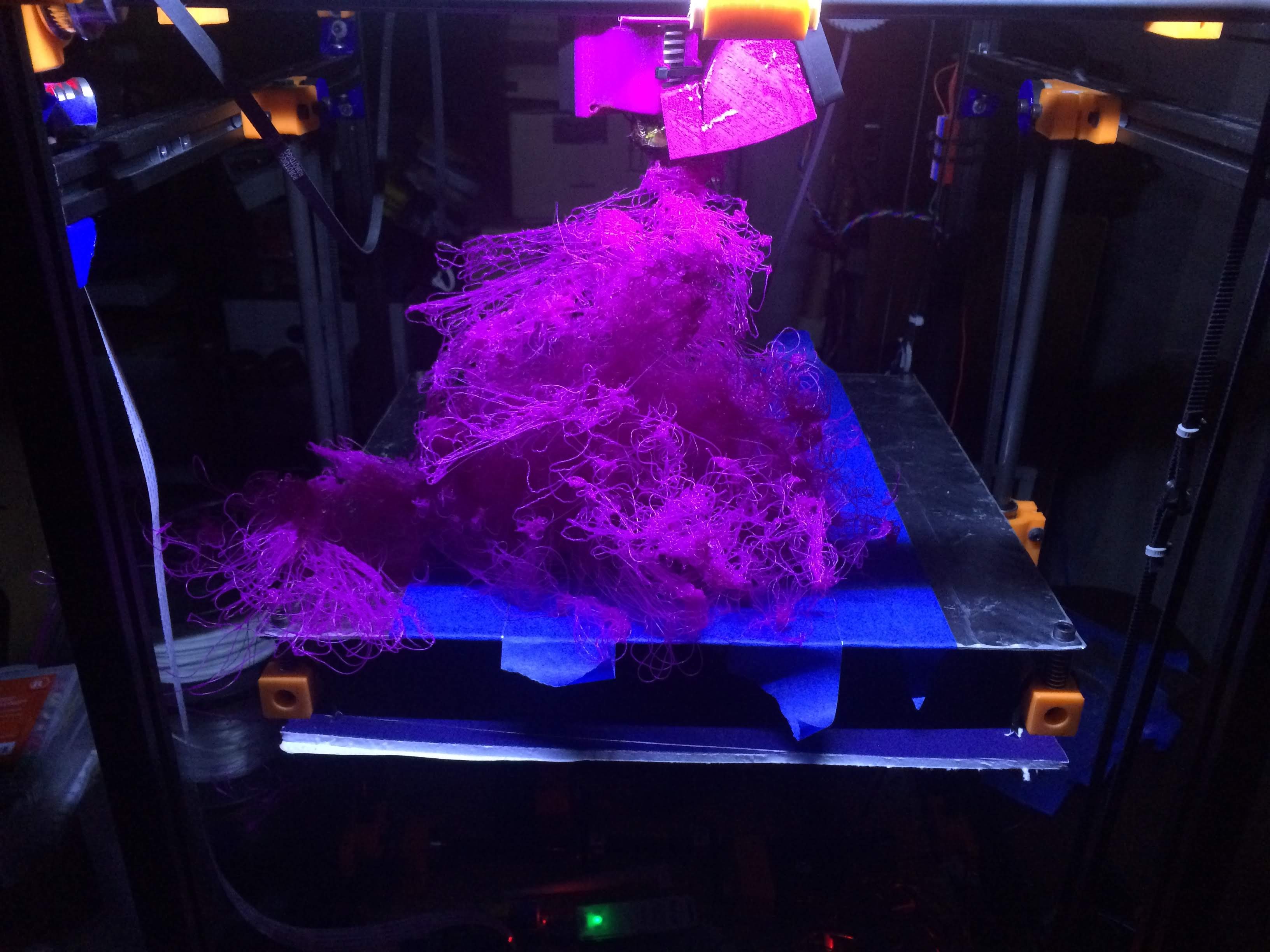

So what exactly happened?

@Griffin_Paquette When I installed the new carriage, one of the cross rods was shifted slightly more to one side than it should have been…the GT2 belt walked off the side and the printer spent the night with less than a full X axis.

It’s not the hot end’s fault, @Shauki …printer lost a rubber belt on the X axis.
