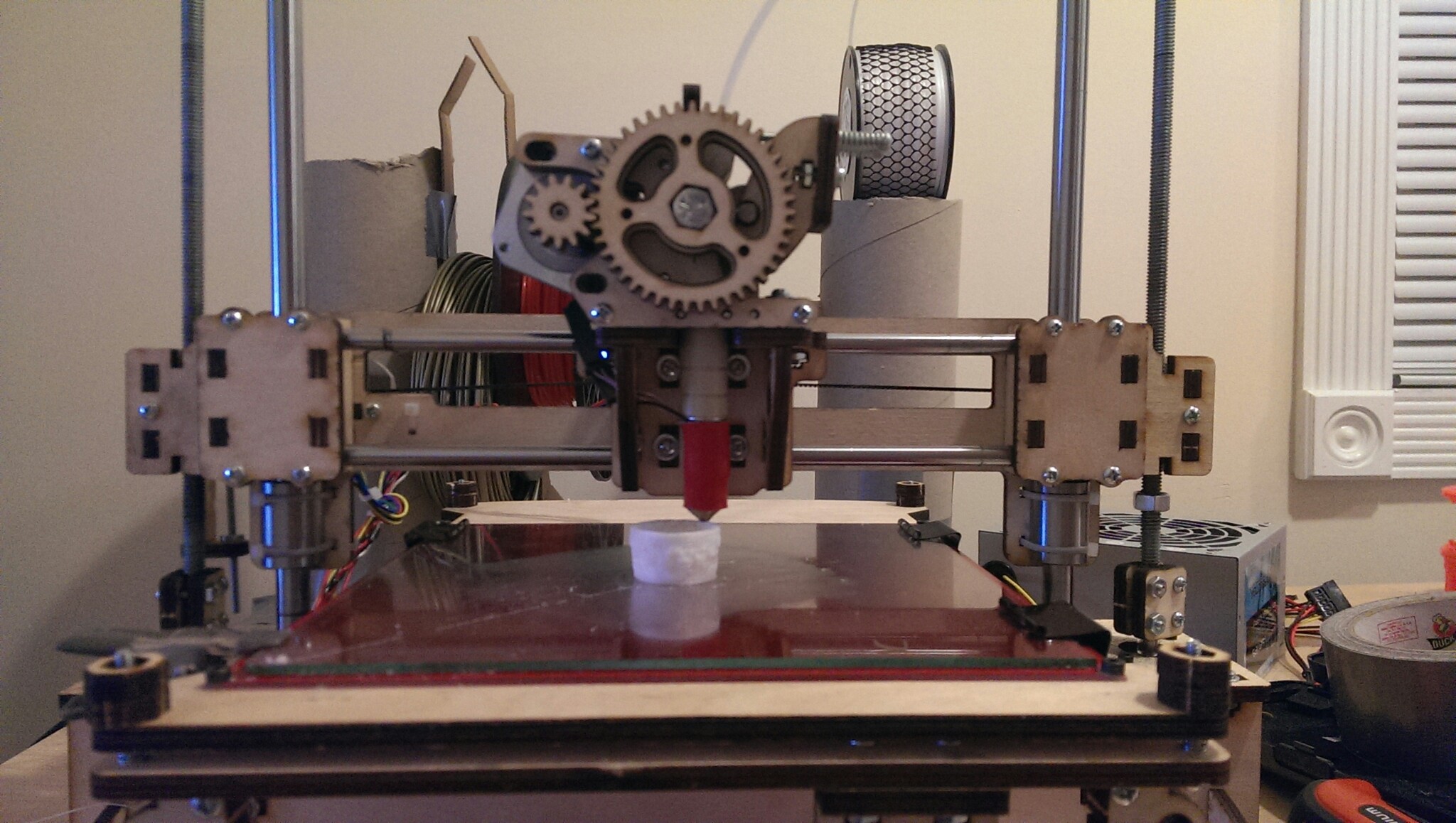

I can’t believe it’s actually printing (rightmost z screw is wonky). The z screws are being replaced tomorrow but I just had to try out nylon and I’ll be darned if I won’t get a successful print in just an hour or two
Nice. Mine is still in transit.
Printbot or nylon? Either way you shouldn’t be disappointed. I should clarify, the reason I’m amazed it’s printing is because the right z screw popped out.
I meant some nylon filament is in transit.
It seems to be very forgiving. I haven’t calibrated the extrusion rate, The extrusion rate seemed pretty good with what i had set for PLA. I set the head to to 240c from the start and the bed is glue stick on old hair spray on heated glass @40c. The first layers from my first three failed nylon prints wouldnt scrape off with a razor blade. Hopefully this tiki head will come off once the base cools.
