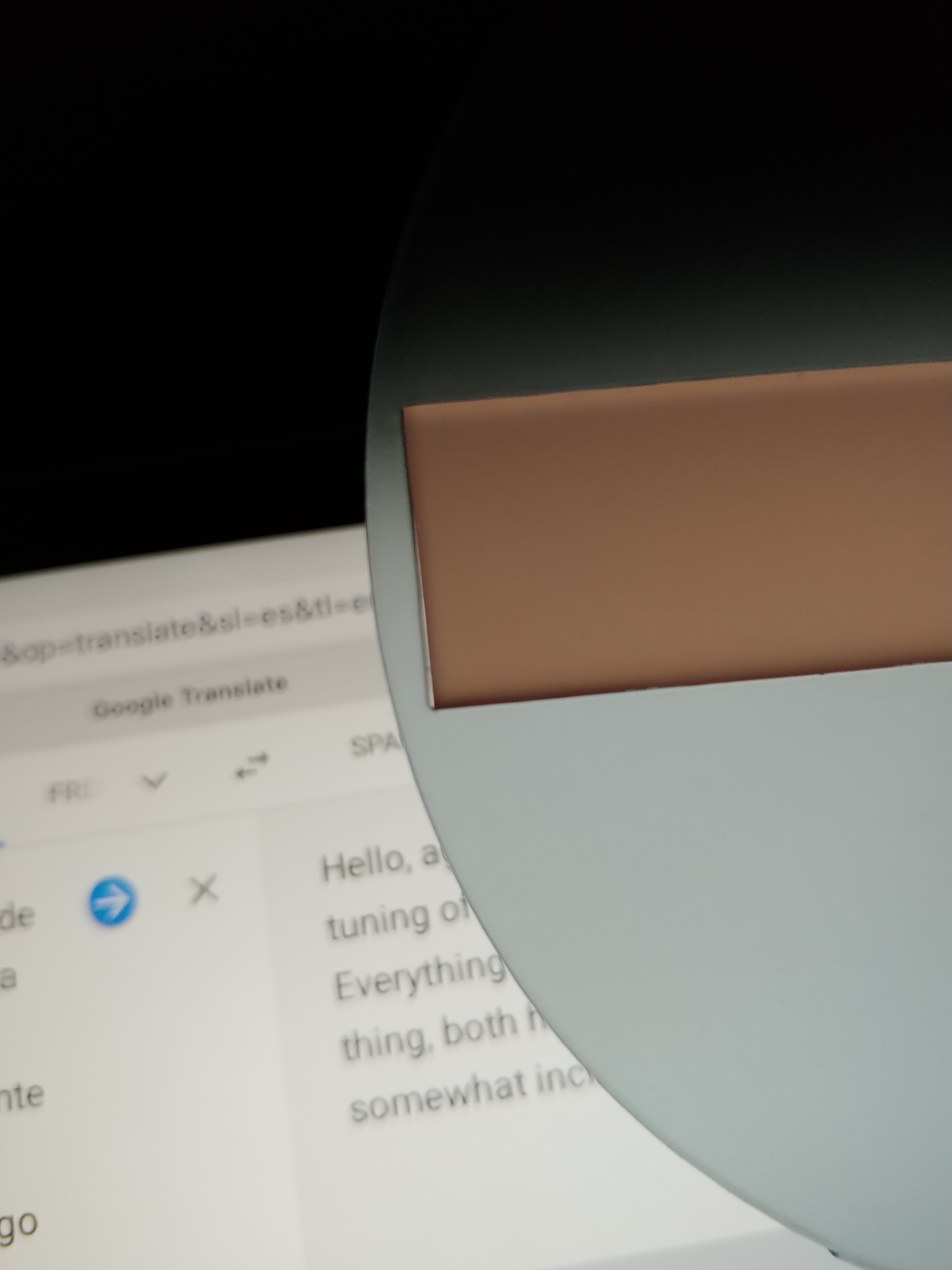

Everything in the machine works great except for one thing, both horizontal and vertical straight lines are somewhat inclined. I can’t cut perfect rectangles. Which may be due? I’m thinking of gantry square .
On the one hand, the vertical, the problem lay in the x-axis bar. It was misaligned. Bad horizontal lines are due to bad tension on the x-axis belt. I thought this was very tight but I was wrong. Right now I still can’t tighten the belt well. I cannot tighten one of the screws well and that side of the belt is still less tense than the other. I am about to break the screw. Can someone tell me some good tutorial please, I am unable to find it right now.
