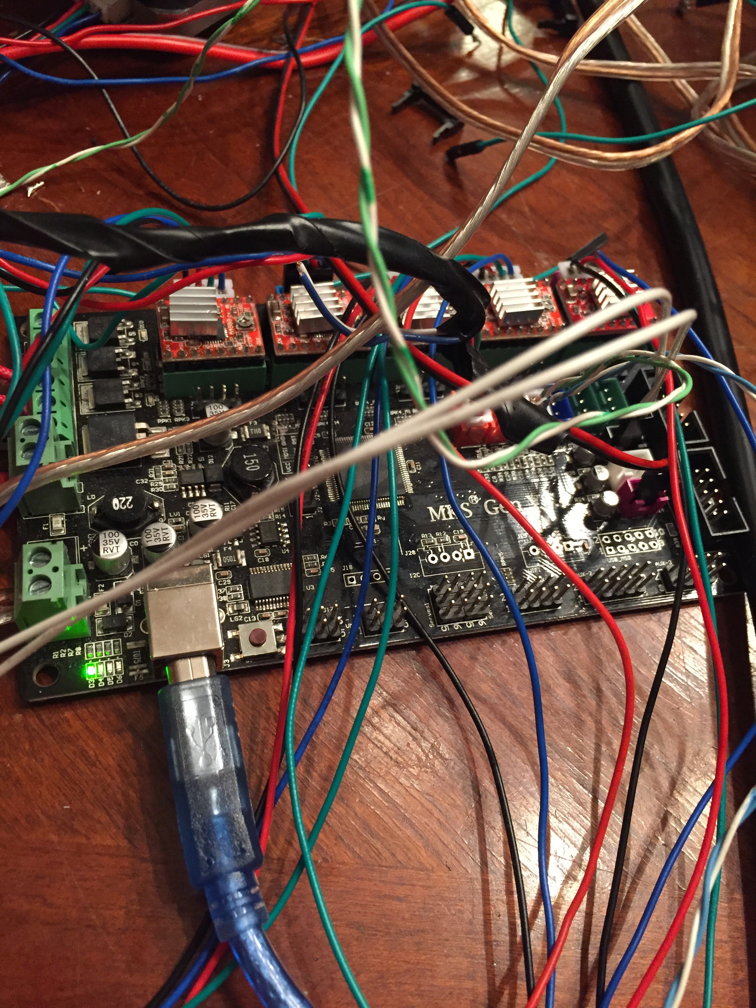

I can’t get my LCD for my 3d reprap to display. It’s just a blank screen (though on) after I uploaded the firmware (via arduino) to my MKS Gen v1.4 board. The wires appear oriented correctly, the firmware appeared to be uploading. The LCD is 12864, but no characters show.

@Matt_Barth Yes, I adjusted the brightness after I discovered that was what the pot was, but the problem remained. I think it could be a wiring or connection problem. When I have figured that I could run the printer without the LCD, that became less of an issue. Right now I’m trying to see if I can either get the heater to work as well as the motors using the prontor face through the USB port.
