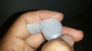

I cant get my prints to stick to blue painters tape properly. And the ones that do have this horrible look on the bottom. The rest of the print is great its just the bottom that looks terrible and doesnt seem to hold to the tape well at all. Any advice?
All painter’s tape brands are not created equal. I’ve had bad luck with cheaper brands and have ended up using 3M so it will stick. If I don’t want to have the texture of the tape on the bottom layer, I’ll add a raft in the slicer app. This all assumes you’re happy with the calibration and height or thickness of the first layer.
There is such a thing as smooth painters tape. It’s for delicate work. And if you’re printing on glass, don’t bother with tape. Instead put a layer of Elmer’s glue on (a glue stick, not the liquid form.)
Yeah its straight up clear PLA from atomic filament. I have a PEI sheet on my print bed but my printer was acting funky recently making the Y motor take too many steps and going way past the calibration points causing it to ram into my PEI sheet and cause several gashes in it. So i sanded them down and added blue tape while i wait for my new sheet to arrive. But i bought the cheapest roll. Thats what i get for being cheap lol
I would reflash the firmware on your printer and see if it fixes your issue. Printed in blue tape for years. Get the duck brand or 3M and wipe it with a very slight amount of rubbing alcohol before printing. PEI is still superior but I understand that saying that isn’t going to help your current situation.
I had to change the steps per mm then change it back and it seemed to fix the glitch. Not sure what it was since i reflashed and factory reset several times with no progress
