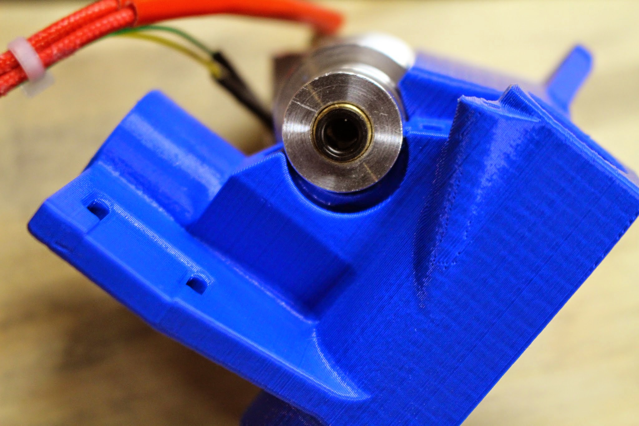

I can’t seem to get my E3Dv6 on the Eustathios V4 print head. This is as far as I could get it on when I attempted to test fit it. I’m afraid my printer might be printing a bit on the large side for some reason, as things always seem tighter than they should be.
Part of that’s the macro shot from the camera. You can’t see nearly that much detail up close. I do agree the bottom side of the fan mount isn’t the best. My support probably wasn’t dense enough, and cura’s infil isn’t great to begin with. Eventually I’ll get simplify3d.
Do you have a file? The fit should be as snug as possible. A few swipes with a file at the 4 corners will allow u to work the hotend in with a twisting left/right motion.
I had the same problem. It worked in the end by cutting away a little bit at the corner of the carriage and heating the E3D with a hot air gun before putting it in place
My second one came out perfect with .98 extrusion multiplier. But on my first I wiped the mating surfaces with a qtip with acetone, then press in (I use ABS parts). Makes it a perfect fit.
Thanks! I still get more inconsistencies in the print than I’d like. I think there’s something weird about my z-axis, as I get all these horizontal bands. I have a complete set of new parts for my re-build, and I’m thinking about moving to the external motor setup.
I’m running into the identical situation, and the dremel is my friend. In my case, I scaled up 1.05% and the carriage Axis that prints parallel to XY came out perfect, the axis the prints vertically needed clearancing with a drill, and I’m still working on getting the extruder to fit snug (ran out of time this morning prior to going to work.) I’ll play with Acetone this weekend.
FWIW, and maybe it says more about my willingness to create stuff that’s ‘good enough’, but if you zip-tied the extruder in place in the photos above, I’d bet it would print just fine.
I will be zip tying it up. This is just a test fit. As for scaling it up, that’s probably going to result in some issues when you go to assemble things. Generally, I prefer to play with the tolerances in CAD instead of scaling things.
In ABS I print based on the the extrusion multiplier that a single 0.5mm walled cube determines (at planned print speeds) for that roll. Then I scale all models by 1.008% which is the standard scalar shrink factor for ABS from 240C down to room temp (Martin gave me this one… he did injection modling system design for years). After doing that parts now all fit like a glove first time.
