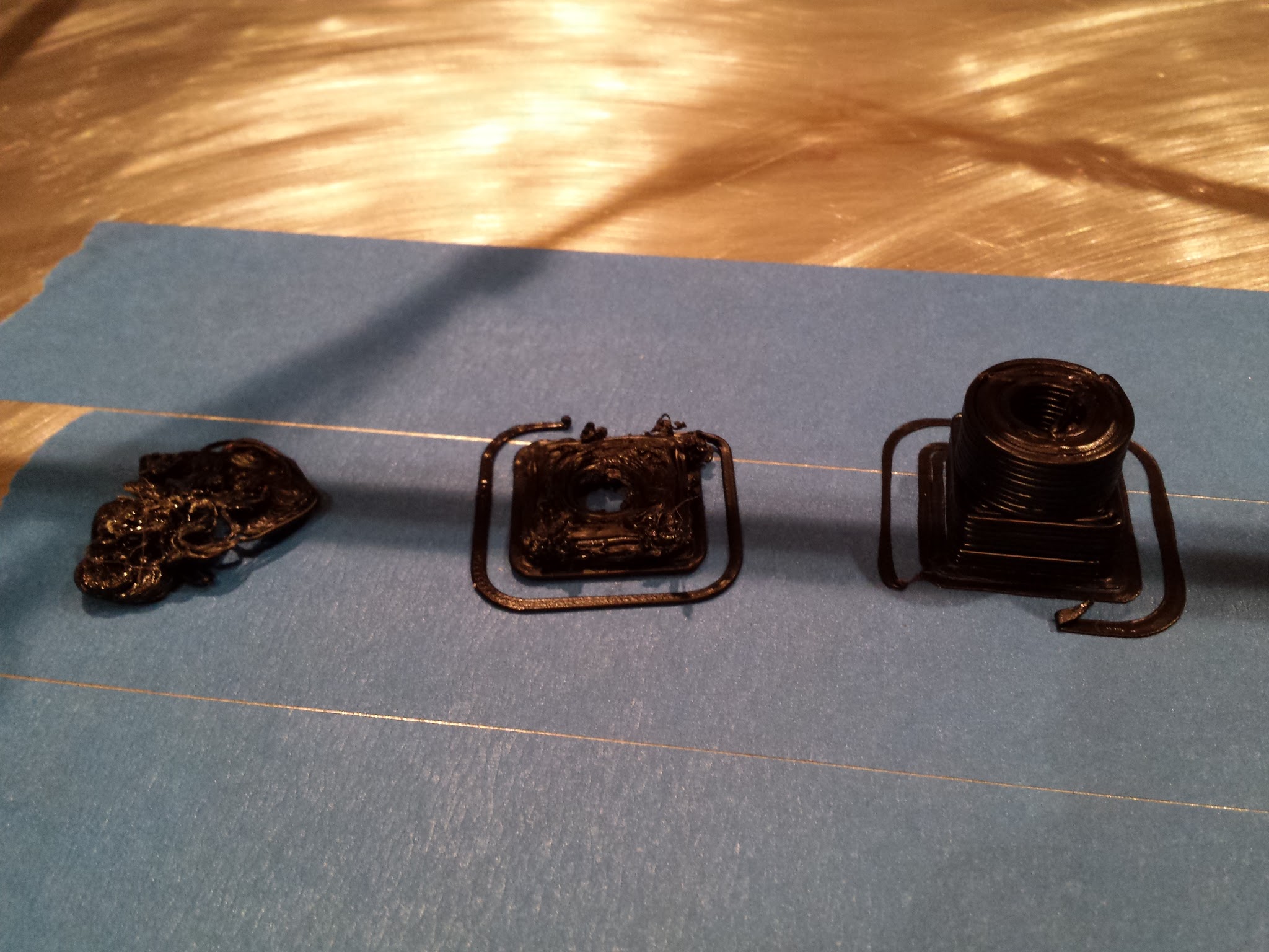

I could not wait any longer for the bed heater to arrive so my son and I wanted to see how it would print … after reassembly the Z-gantry and build plate (lot easier with help) we tried a test print of a square with a cylinder. We warmed up the build plate with a heat gun and after screwing up all the settings in Slic3r settings in Pronterface we finally see a recognizable object. I wonder if there is a noob setting for all the variables we have?
This was printed using black ABS maybe PLA would be easier to start with? I am using the largest Volcano 1.2mm nozzle which I have incorrectly set to .5 (default). The first few prints I mistakenly set the extruder multiplier to 2 and 4, all the extruder did was burn rubber on the fillament thus causing a lot of missfeed, and finally going back to default of 1 (default) worked out and after reading about this setting a 4 = 400 percent is much too high! DUH!
