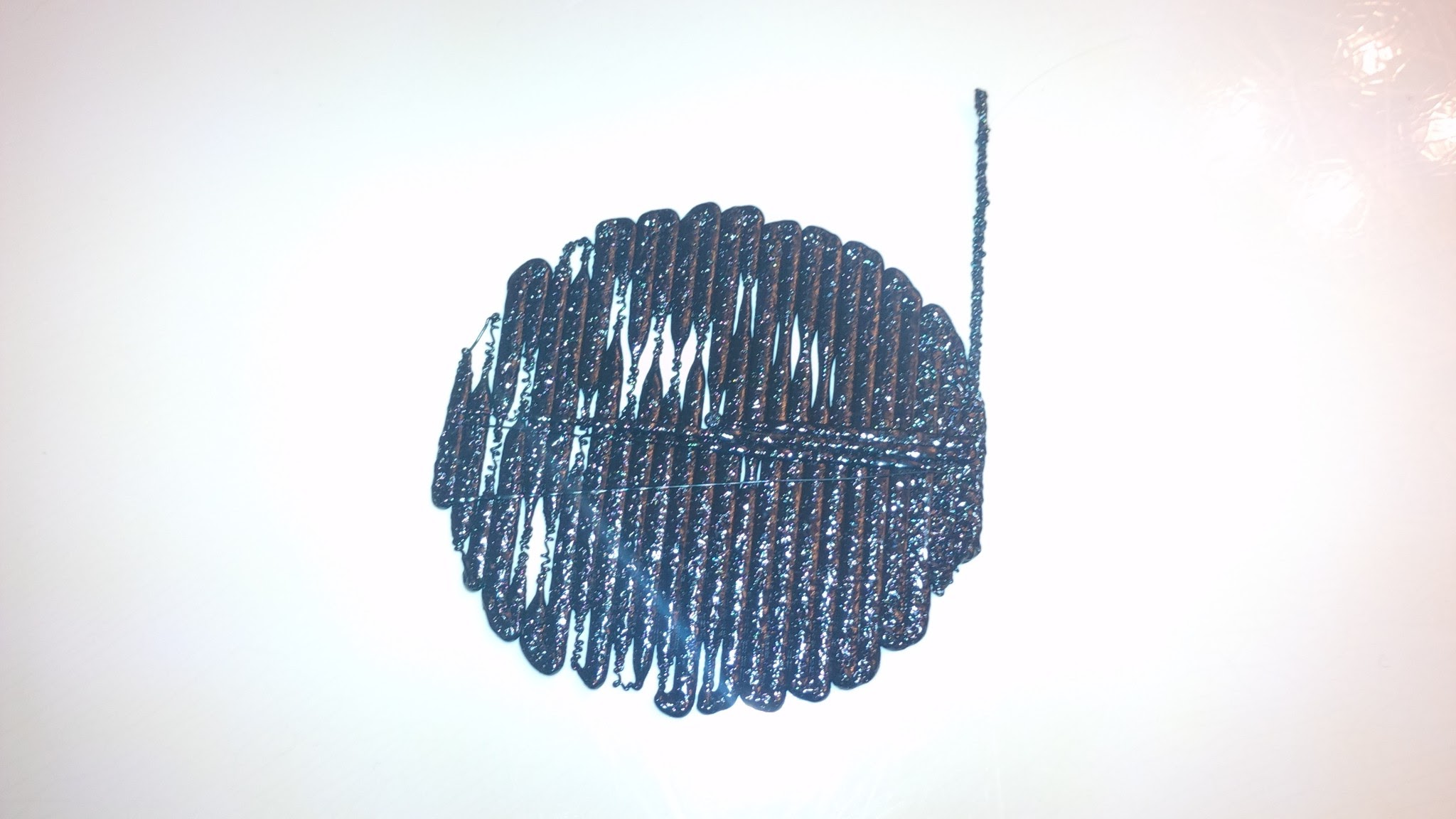

I could use some help! After a long hiatus, I’ve started trying to use my ToM again, and I’m getting terrible results. The plastic is, at best, coming out big and blobby with what looks like air-bubbles in it, but it is also often striping on the hobbed gear and thus not coming out at all, although it starts up again if I push on the filament a little. Attached are some pictures of a raft printed today.
Any ideas on where to start debugging this? I’m guessing the bubbles are because the ABS has absorbed too much humidity, but I Think I should be getting a thinner, neater raft than this, and I don’t know why the extruder would be so unreliable.

The bubbles are because your plastic has absorbed water and that water is now boiling out at extrusion temperatures. Get some new dry plastic or dry out what you have (low heat for a long time)

You sure that’s ABS? The highlights in the photo are a little bright, maybe your flash blew out the photo? But this is what my PLA looks like when extruded at ABS temps.
Definitely ABS. The flash did blow out the photo.
