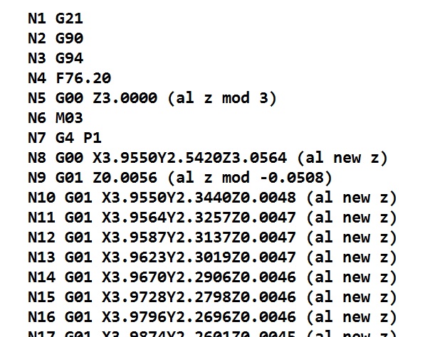

I couldn’t get the leveled gcode from chillipepper.
So here are the photos of the first few lines of my original and leveled gcode.

I think the Gcode looks correctly modified and the new Z values that were injected look reasonable. So the question is, does it just come out wrong when you mill? Is this referring to the past PCB you were milling? If so then I think it’s just your milling hardware now because this gcode looks good.

Like I said in my first commend chilipeppr showed z: 0.043 when finished the probing of first point, then how it became 0.0056.

I hate to point out the obvious, but it looks like you’re trying to mill traces with a depth of zero which pretty much will get you no traces. Why are you doing that? 2 oz copper on a PCB tends to be 0.2mm thick. Why are you not milling with at least 0.2mm of depth if not 0.25 or 0.3? You are milling with a depth of zero which obviously would not work??? I noticed this a while ago but some people do it this way but they create a G54 offset down 0.2mm or so and then mill. You did not do that in your video. What are you using to create your gcode for milling the PCB? ChiliPeppr has an Eagle BRD import with defaults that would help save you.
@jlauer I’m ot much familer with this PVB milling, doing it for the first time . I found one project in inventables https://www.inventables.com/projects/pcb-milling-on-x-carve
and fllowed the steps (that project recommend a depth of 0.05mm). I will try with a 0.1mm(my Cu board is 1oz) depth next time .
