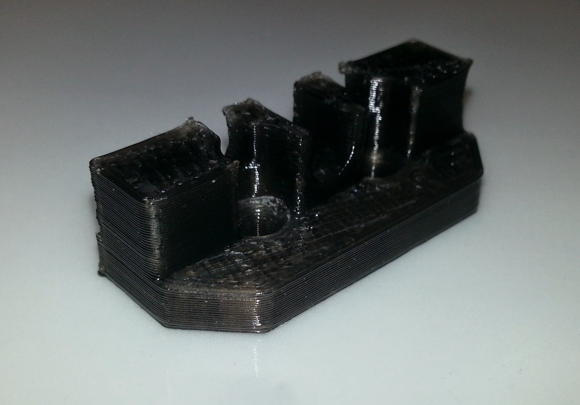

The result is quite good. But if you look carefully you can see the the top corners are a little higher than the surface. On the other hand, some of the other details seems more well defined than the same print made in PLA.

Is it the lift curling the top. Or the over hot ext? You need a fan on extruder to keep it from melting? I haven’t ran but a small patch of nylon. I thought it’s temp was lower. Looks fun! Good luck!
225 sounds like a temperature for ABS. I have not used PLA myself, but I know it prints at a lower temperature. I have had some premature oozing with ABS. I often extrude and then retract 10mm or so before starting the print. Something in my settings also extrudes a little bit of filament before printing, so this works out well for me. Now if only I could get the rest of the setup to work well for me.
225 is my ABS temp. 188 ish for PLA. Z lift can make top curl and spread oozing if too hot. Retraction always helps but…
Thanks for you comments. I will try a lower temperature for the first layer, and change my z-lift settings. For t-glase the recommended optimum temperature is about 235 to 240, but it will print down to 212 and up to 248. I don’t know how well calibrated my extruder temperature is, but for PLA I use 185 with good results.
