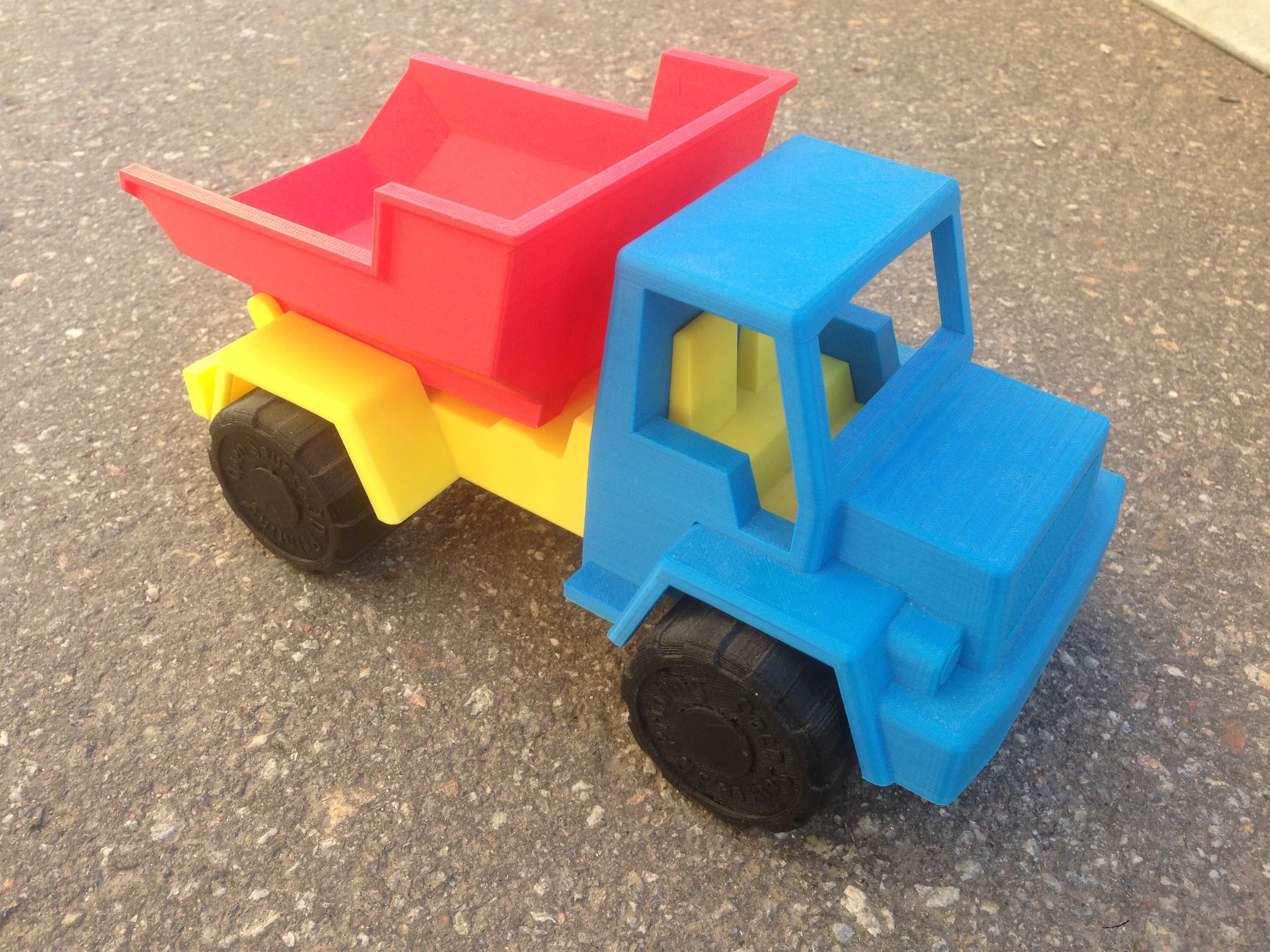

I designed and 3DPrinted this toy dump truck about 2 years ago.
I designed and 3DPrinted this toy dump truck about 2 years ago. Almost all parts are printed in ABS except for the wheels that are printed in PLA.
While the ABS parts still look fine the wheels (hard to see on these pictures) are now starting to delaminate in some places.
Will be interesting to see what they look like after another year… =)

Which brands of filament did you use? Would it be different with other (better?) PLA brands? How would PETG compare to the PLA?
@Brook_Drumm Of course, i always do! Check the link above. =)
@Nelis_Willers the ABS is from MakerBot and the PLA was something I got from Mbot. PetaG or a co-polyester would probably be better.
Do you remember the temperature you used for the PLA? The color looks a bit “off” for the PLA prints that I have (I have 4 year old prints that seem to be doing fine) it might have been printed too cold?
Do “you” use the truck indoors or out in the wild, where uv and humidity stresses the material?
