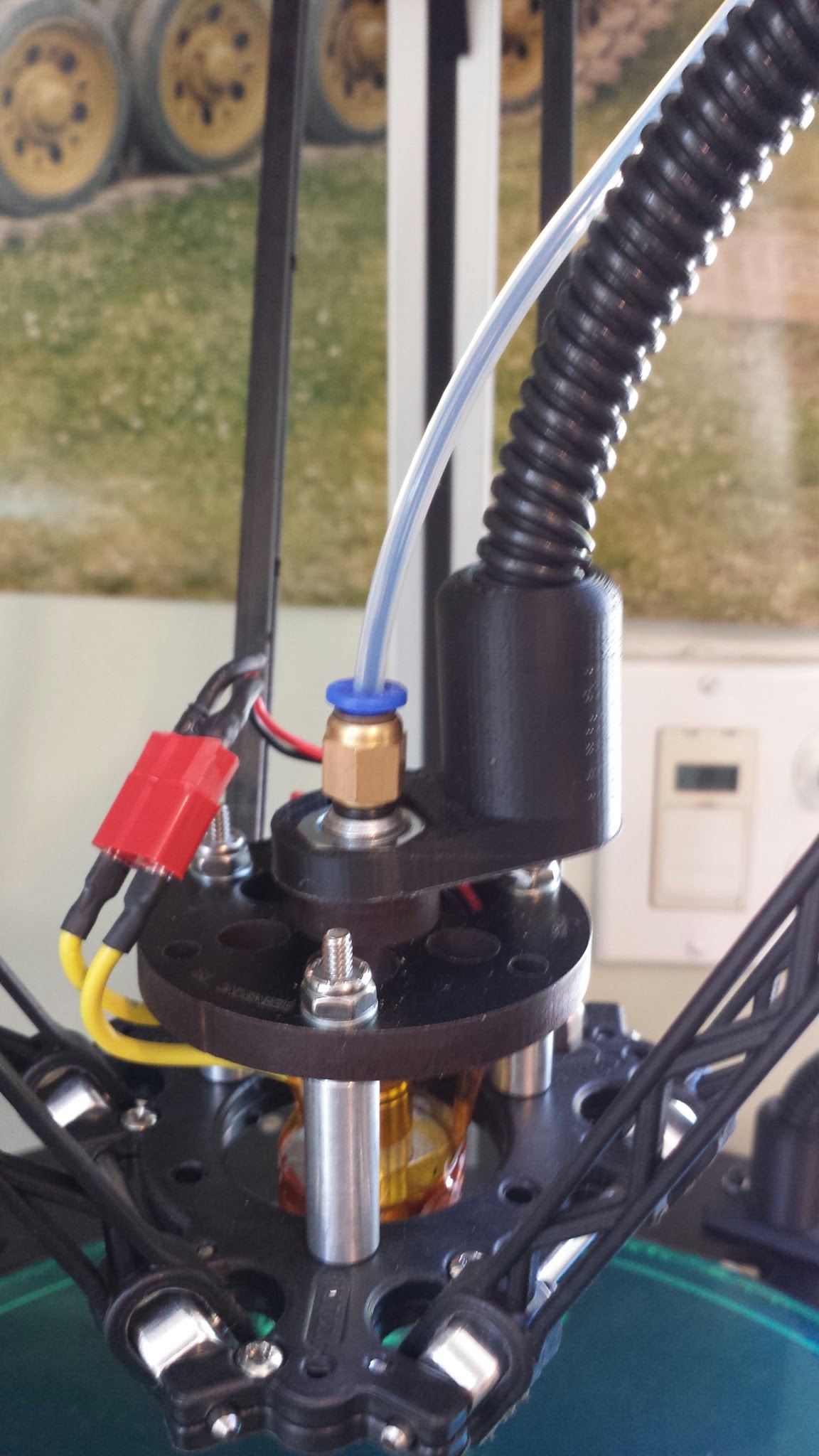

I designed and made a bottom and top mount for some flex split cable tubing to run the wires between the hotend and the base of my Rostock Max.

I uploaded both to thingiverse if you want to use them. They are internally threaded for 3/8 split flex tubing.
