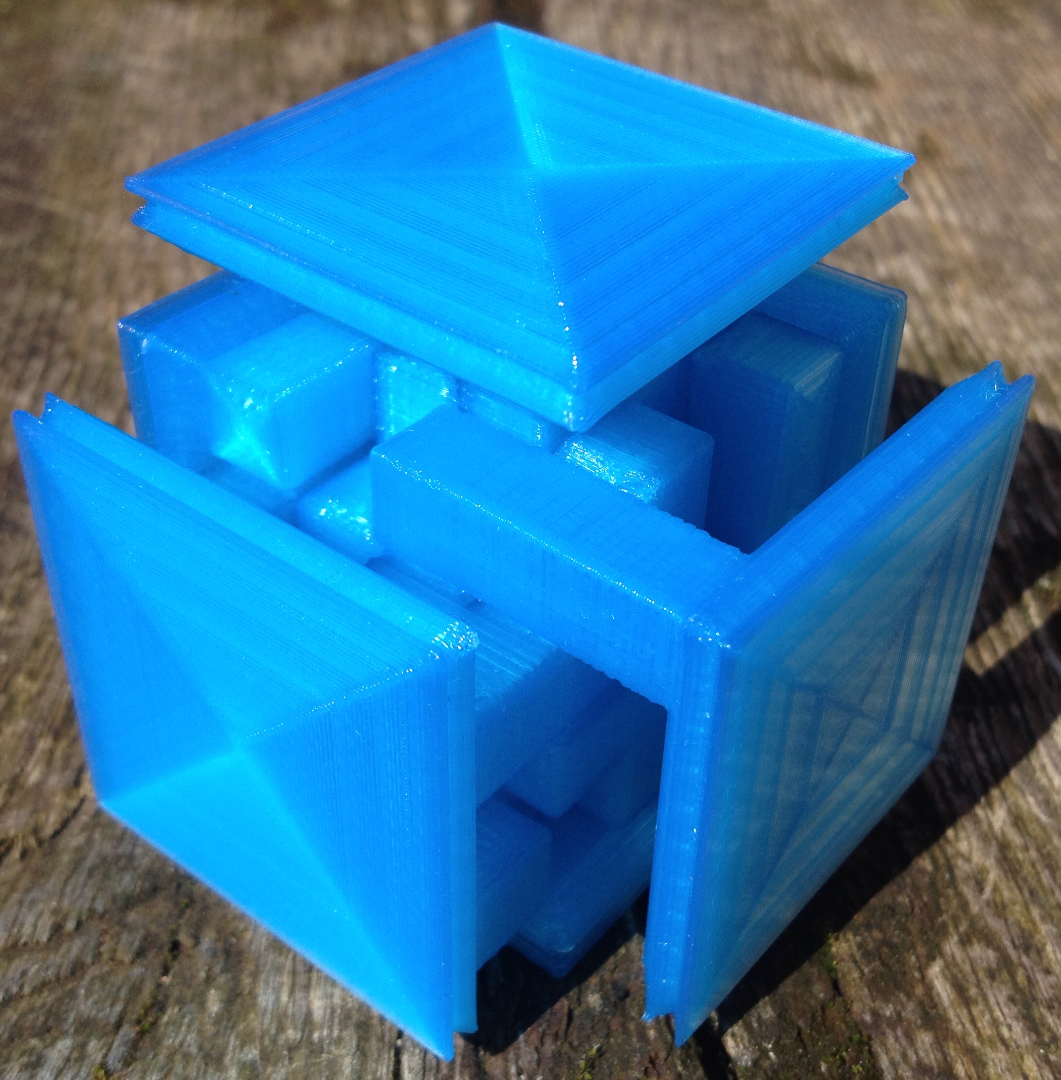

I designed my Steady State cube puzzle about 5 years ago and still sell it through the microcubology shop at Shapeways. It was always my intention to be able to print copies of my back catalogue puzzles on my RepRap printers but the support material removal has never been clean enough to allow this - until now.
Simplify3D has come up trumps again. The concentric fill works beautifully on the faces and the support material came out so cleanly using only my fingers that I was able to assemble the six pieces immediately. Seriously impressed!
