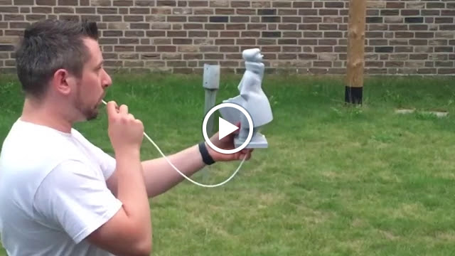

I did scan and print a local statue that does “spit” for like 2-3 seconds every minute or so. Does anyone have an idea how to recreate this in an easy way? Would a solenoid and a small aquariumpump do the job?
