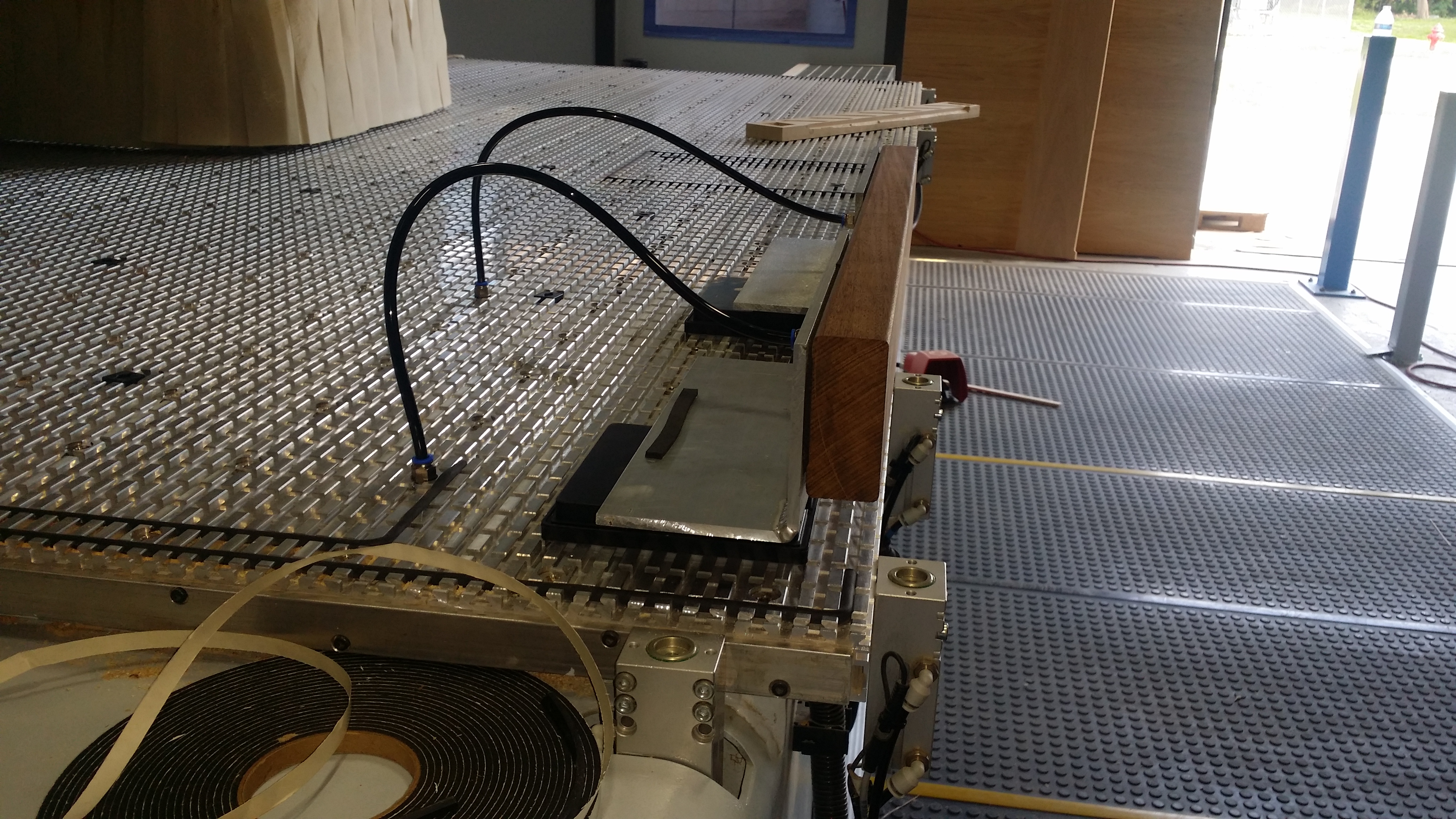

I didn’t build the cnc, but the vacuum fixtures I did. We currently only have a fixed 90 degree to the z axis aggregate head that operates on our interpolated c axis. This fixture allowed me to make pockets in a part that I typically would have needed an angular aggregate for (B angle) as the pocket goes in at around 30 degrees from the front face.
