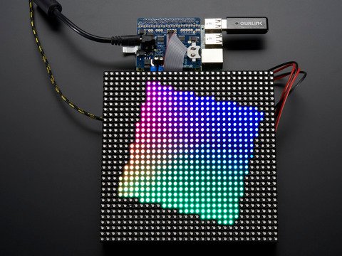

Since I can afford to spend a bit (company money) and I want good color resolution and power and control, would it make more sense to look at python and raspberry pi? I do a lot of color analysis in python, so it would be awesome to have a real-world interface with my code to visualize.
Something like this
Depending on how heavy the math is - yeah, you may not want to run it on a small embedded MCU, certainly not one that doesn’t have hardware floating point - if you go the addressable led route, I think you might want to go with a 12-bit or 16-bit driver as well (FastLED doesn’t support 16-bit output yet)
@Daniel_Garcia Ok, well I don’t want to overengineer anything just yet. I’ll start simple with the fastLED lilbrary, an arduino (we have an Uno), and a good resolution ledmatrix display.
Do you have any recommendations for an easy to make led-matrix like the video above? A small pitch would be ideal.
