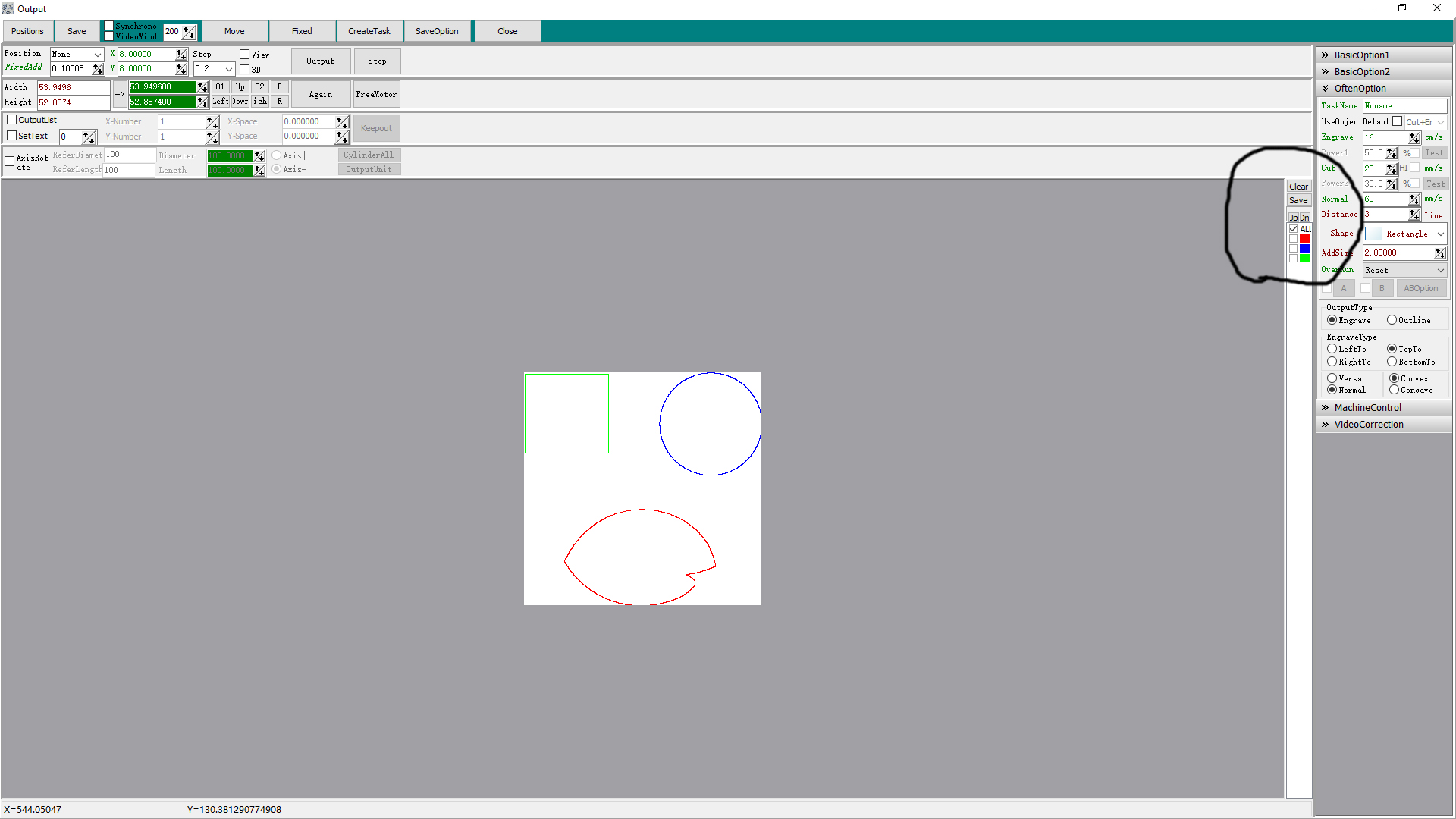

I don't know if anyone has posted this before,
I don’t know if anyone has posted this before, you cut and engrave without changing output screen. You can set the colors on the cutting screen and only work with 1 at a time or multiple.
And what software are you talking about?
Looks like you are using Moshidraw software. You need to search the Moshidraw forums but I do not think it supports engrave and cut in one process.
Never used that software so I had never seen that screen. I have been using K40 Whisperer and etch then cut acrylic all the time for LED end lit images.
Moshidraw is for the Moshi control boards found in some of the K40 units. K40 Whisperer will not work with the Moshi board.
