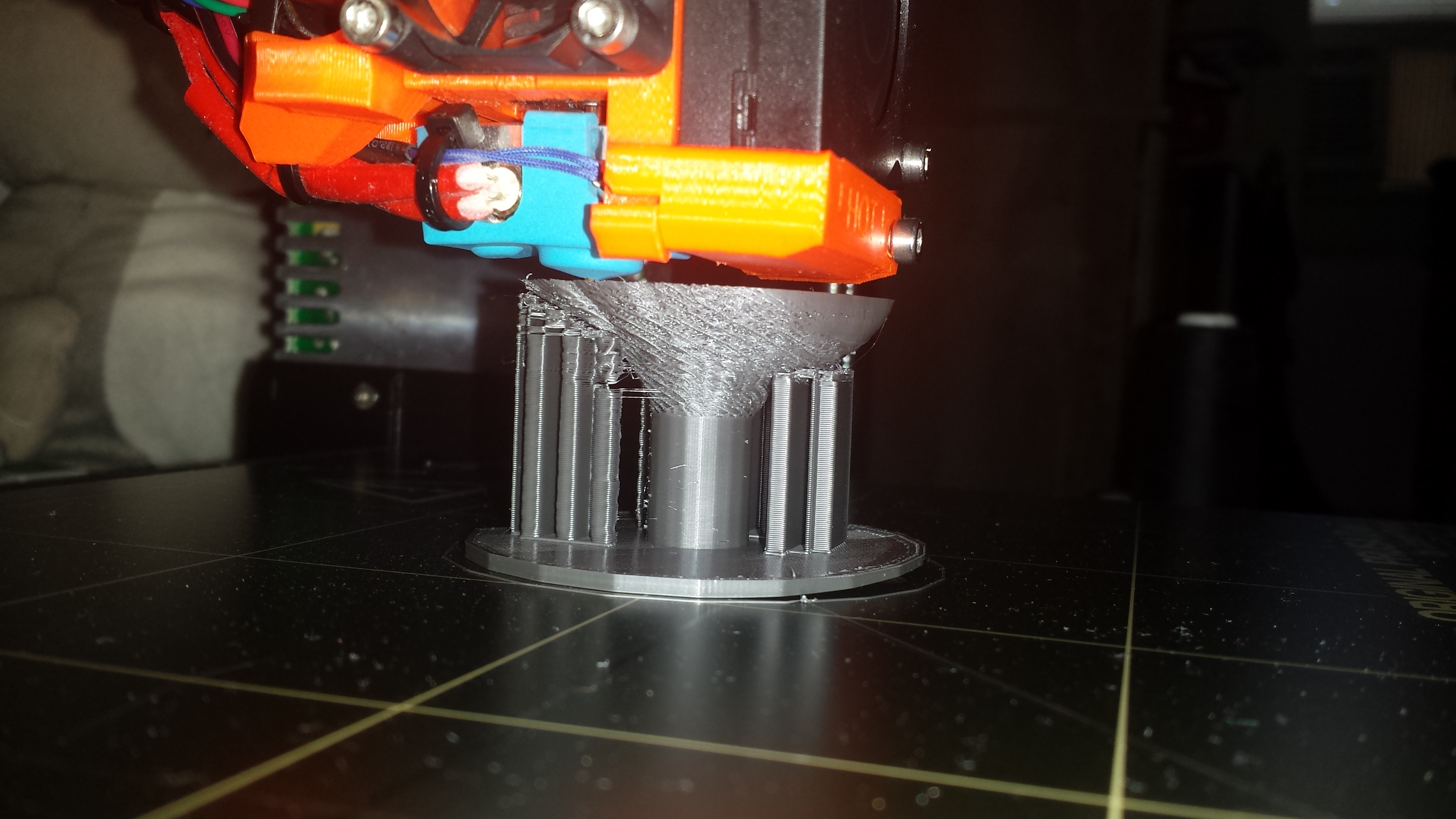

I dont think that looks right...
I dont think that looks right…
Looks like jamming to me
Accidentally had flow set to 95. You can see where i upped it to 100. Too late to stop now ill just sand it i guess lol
Why do you have a zip tie that close to the hotend? You are gonna melt that plastic and permanently stick the wires together.
Idk that was on there when i put it together lol
Im scared to cut it thou its right on the wires
Did you have the print pulling off he bed on the right side?
No pulling off the front. The right side was still held down
Hmmmm…right side of the picture?
