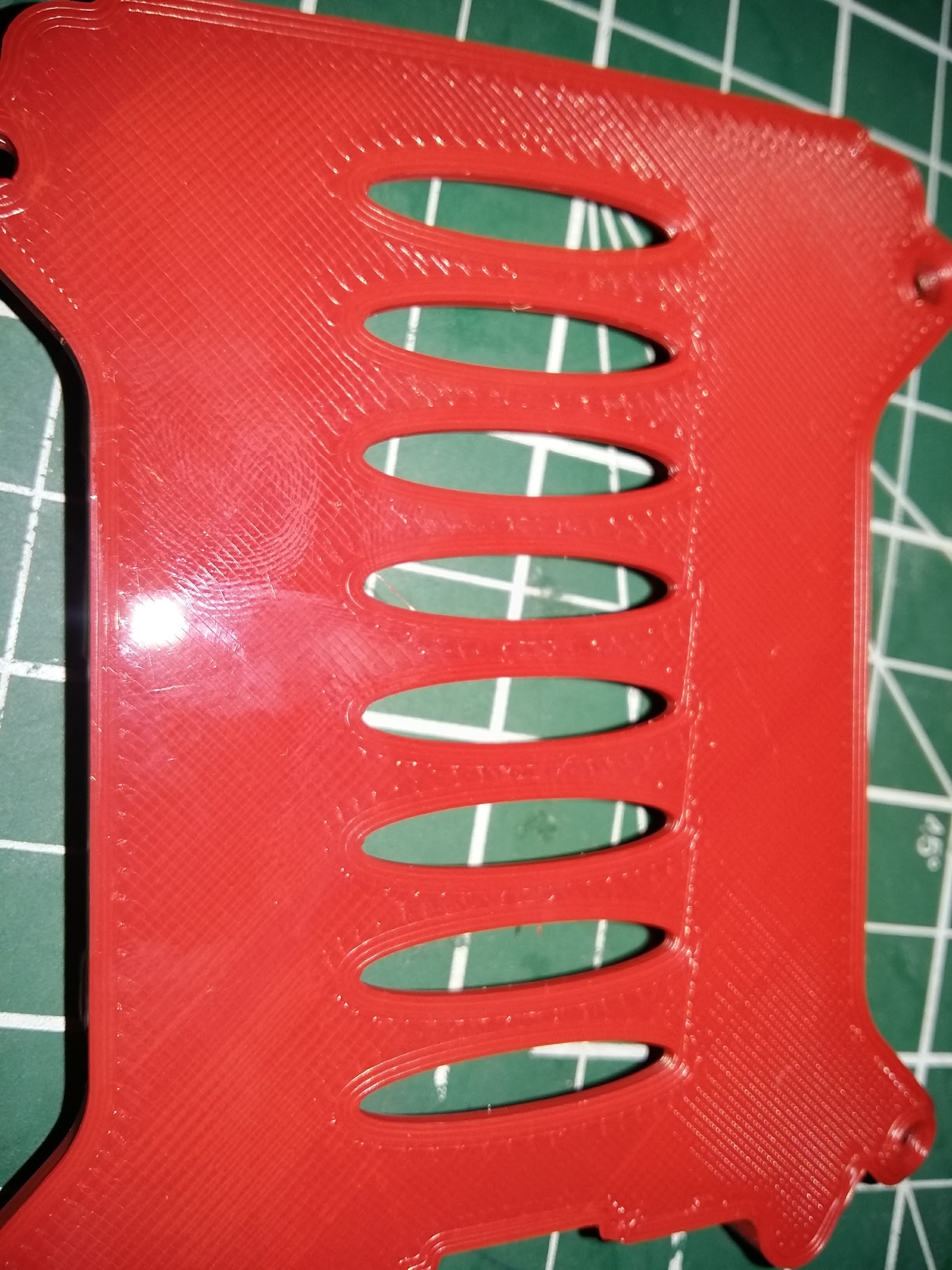

I dunno where i saw it, but i did it anyways (nothing to lose)...
I dunno where i saw it, but i did it anyways (nothing to lose)… so here i share my experience:
I had some Johnson automotive window film laying around… so i put it over my glass…
fantastic results.
ABS sticks to it when warm… detaches by itself when cold. Bottom layers are beautiful.
tried with PLA… it sticks good as well.
bottom of the prints are shiny… have some mirror effect if you ask me (it is not really noticeable in the pictures)
don’t ask me what this stuff is made of… i just know is johnson brand. Some internet sources says automotive window film is PET… some other said acrylic with some additives… either way this works.
(Brown is ABS, black is PLA)…
