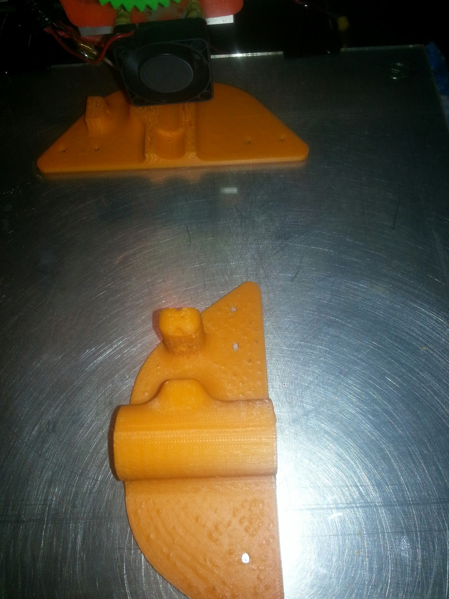

I feel like the new Cura has given my print acne,
I feel like the new Cura has given my print acne, but I will say the inside of the push fit bushing tube are better than ever
Moisture in your fillament?
yea thats what it looks like to me
No everything is fine until it goes over the support material which looks like an attempt at squares but seems spongey. the support starts like rectilinear then comes over with 90deg twist to make square voids by just printing between those lines. No bubbles anywhere else. Going to try with thicker top and bottom shell
I never liked square infill much. I changed to circular infill because the square infill seemed to have no strength (I use KISSlicer).
