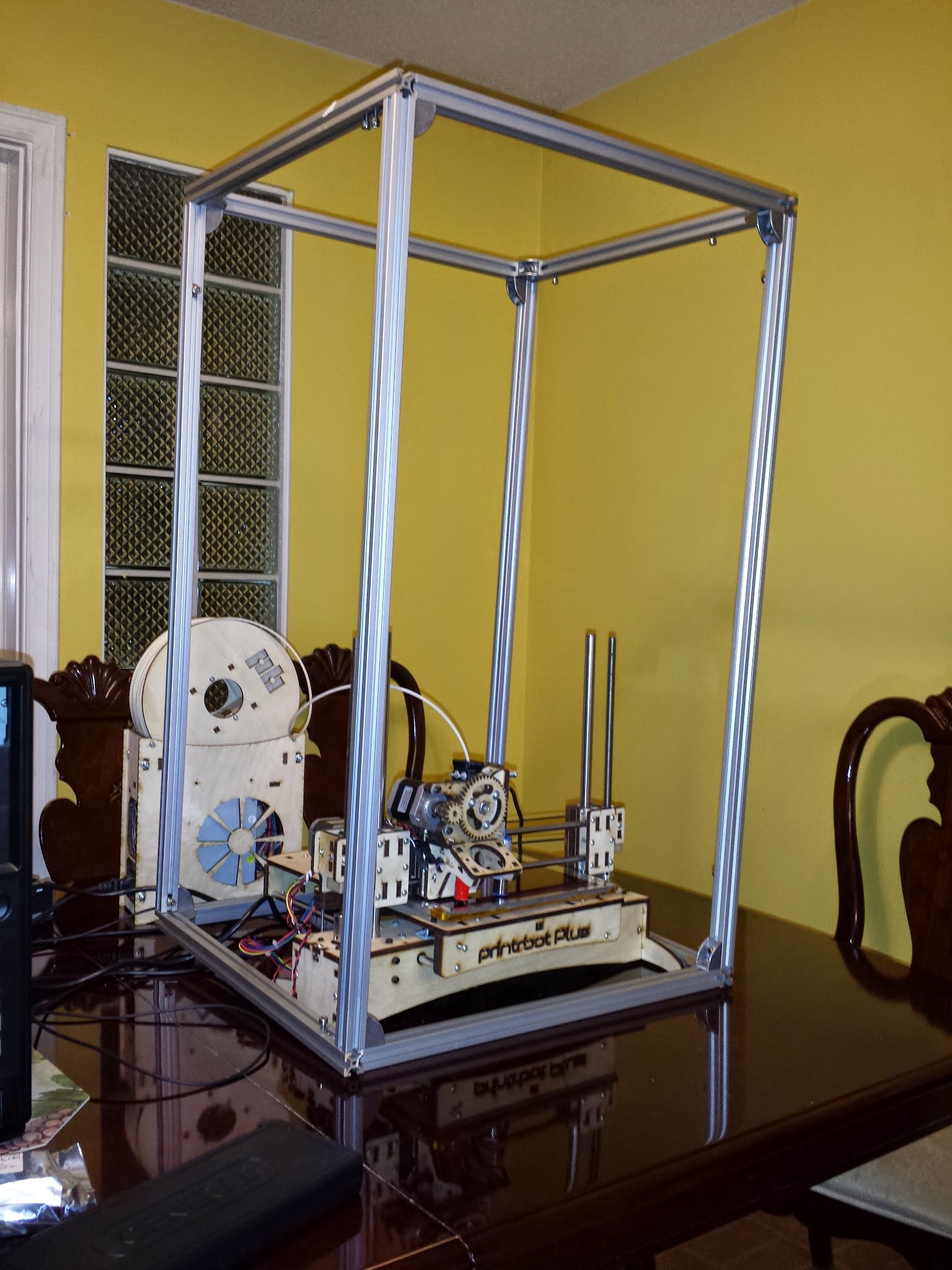

I finally got around to test fitting my extrusions together for my next bot. They are 800mm & 450mm long (Misumi HFS5-2020-800 & HFS5-2020-450). For an easy visual size comparison I put my Printrbot Plus v2 inside it.
It feels pretty darn rigid, too, and it should get better once I put the rest of the corner brackets on it. But I will probably want to order 2-4 more 450mm pieces (or 2x 450mm and 2x 410mm?) to make it a little bit stiffer.
I have to say, I had soooo much fun putting this together! I felt like a kid with a freshly opened gift of an erector set! Which makes complete sense, because aluminum extrusions are like the adult version of it. Good times…
Is there a reason you didn’t butt the horizontals to the verticals? You can avoid the angle brackets that way. The ends need to be square to work well. It looks like you did it on the horizontals to connect to another. You can gain 20mm in X and Y this way.
This is my first foray into extrusions, so the quantity and size were chosen semi-randomly. This is also why I didn’t put all the brackets on yet, and why I posted here—I knew somebody would suggest an improvement such as you have done—thanks! (it was also late and I was dying to just hurry up and try it out)
Initially, I wanted a frame to hold a rework of my v1 Printrbot Plus (not shown, it has the Super-Z upgrade and is taller) into an Ultimaker-ish variant, with the key change being to have either a stationary build platform, or to only have it move vertically, like the Ultimaker. Also, I bought these before joining the Ingentis community, so I only bought enough for just the box itself thinking that would be enough (newb!). As I said above, I will probably want to order 2-4 more pieces to make it a little bit stiffer.
Also, I bought the ends untapped. I later bought a tap & die set to enable the possibility of blind joints, which sounds like what you are suggesting.
BTW, I’ve never used a tap & die before (always wanted to!), so while I’ve read about it and watched some YouTube vids, any tips from experienced folks might be helpful.

Also @Eclsnowman , do you suggest using the Misumi option of having the ends of extrusions tapped and then having countersunk holes drilled through the verticals? If so, I can see that working for only one of the horizontal axes (x or y) since doing both would mean a screw would have to intersect another… ideas?
