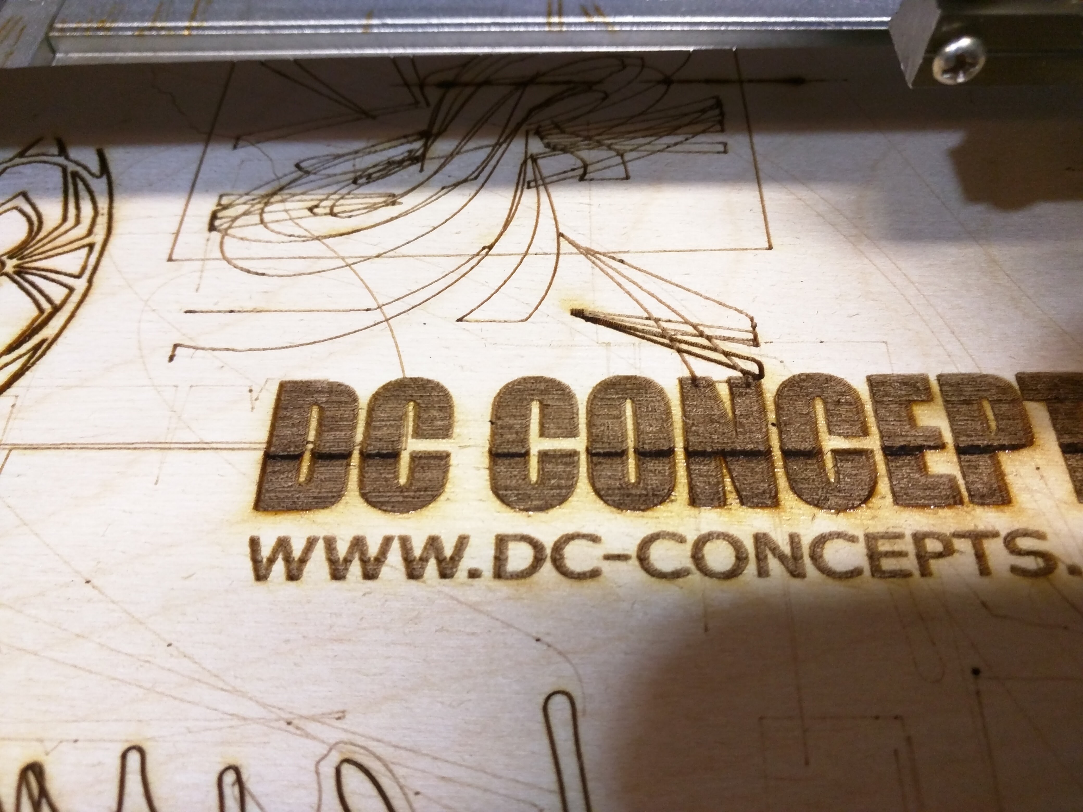

I finally got my converted K40 working! Using a Ramps 1.4 controller plugged into
I finally got my converted K40 working! Using a Ramps 1.4 controller plugged into a Kangaroo 64bit Windows 10 micro desktop PC. Exciting!!
My garage smelled like a forest fire lol. So I finally got my exhaust hose hooked up.
Now I just need to play with the software and settings next.
Using Turnkey Tyranny Marlin firmware and the associated Inkscape plugin
