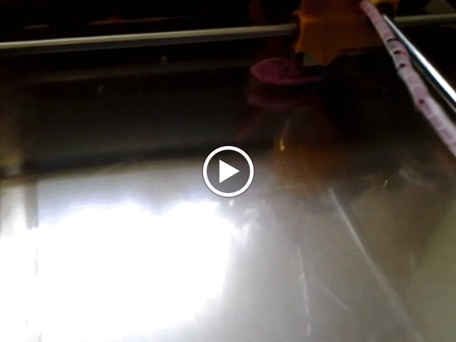

I finally got my first print in ABS on my Eustathios Spider V2. It took a little while to get all the linear rails perfectly aligned and the carriage moving with very little friction. I like this printer much more than the moving bed designs of the RepRaps and I think this design is a great starting point to branch from for all my future 3D printers.
