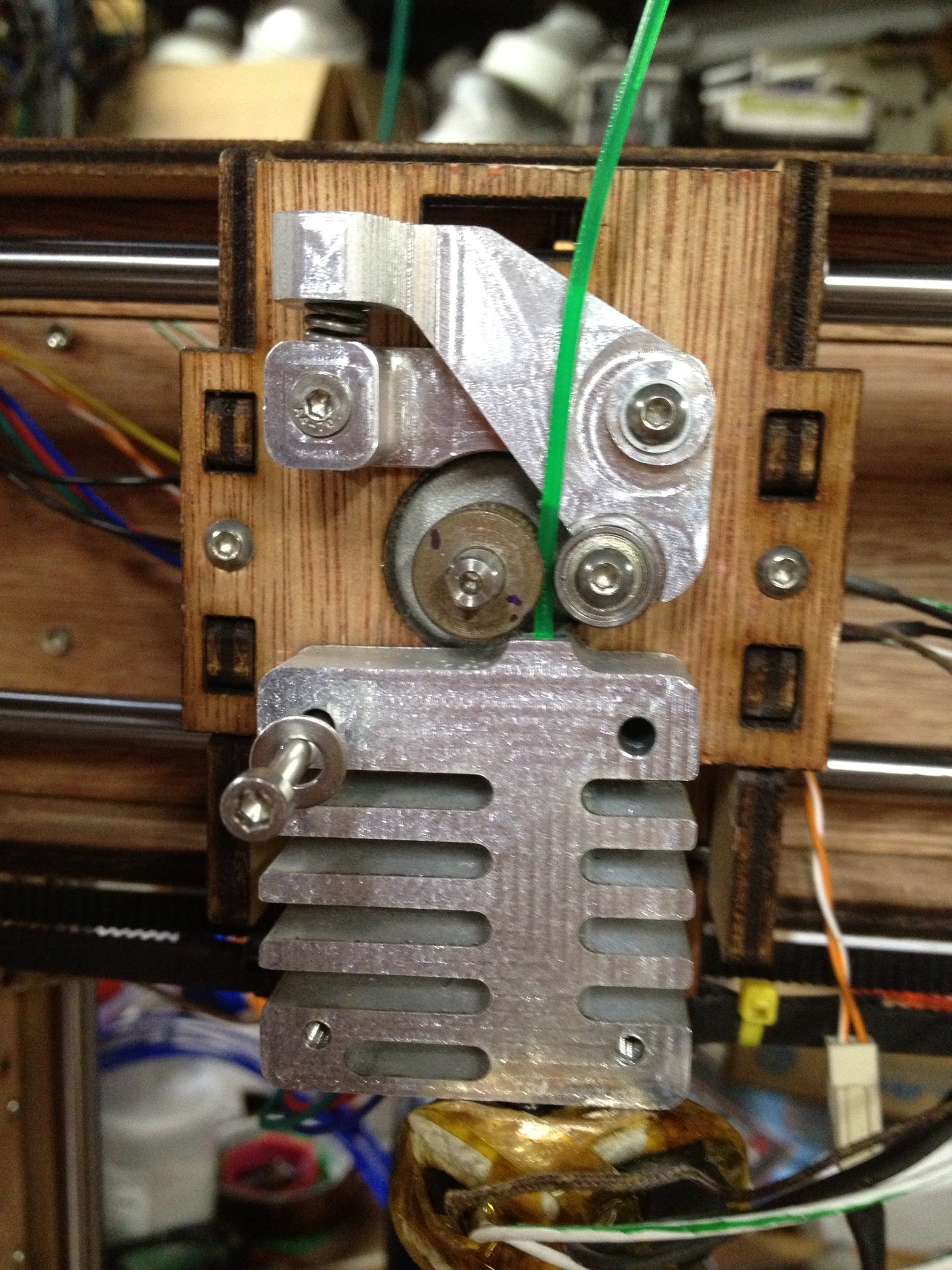

I finally got the extruder sorted out on my “ultimate thing-o-matic upgrade”. Because the extruder hot end has to be much longer than it was on the thing-o-matic, I had to figure out a way to extend it. After much experimentation I finally came to this setup. The makerbot aluminum block was replaced with a cnc machined aluminum heat sink with a 2mm hole drilled through it and 6mm threads on the bottom. I machined a new heat barrier tube from stainless that is pretty much like the makerbot one but a little shorter and thinner to reduce heat transfer.
The drive is one that I designed, printed and tested in PLA and then machined out of aluminum.
The hot end has successfully completed 8+ hour print. I just installed the filament drive so it has only printed a bunny.

This is the “Type1” upgrade, isn’t it?

The extruder is here:http://www.thingiverse.com/thing:102424
The heatsink is here: http://www.thingiverse.com/thing:102427
It is the Type 1 upgrade.
