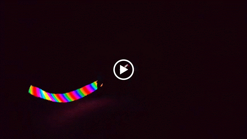

I finally had an interactive thing with the fastled, neopixel, ikea cable wrapper combination.
I finally had an interactive thing with the fastled, neopixel, ikea cable wrapper combination. A jump rope that supports up to 4 people. Will try and improve on this, but if you have any ideas share please.
That looks very pretty, can you post some photos of the construction?
