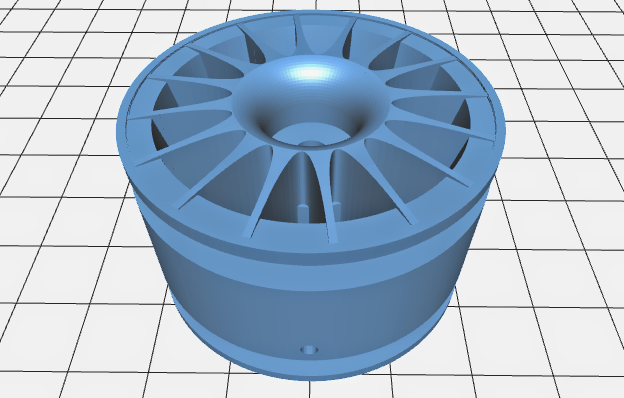

I finally tamed openscad (and a little inkscape) for my now totally free Tamiya M-03 wheel design. Given up with the Alleycat design as it was depending on layer bonding too much and kept splitting, this OZ WRC design has spokes right up to the face so may prove stronger.
Clicky for a github 3D preview: https://github.com/brackendawson/M-03_wheels/blob/master/M-03_OZ-WRC.stl
Don’t attempt to render unless you have a lot of RAM. I’m still deciding if I want to try and design a monocoque chassis in openscad.
It is parametric to an extent, the offset and the amount by which the spokes push out forward is adjustable.
Not printed this one yet, printed other spoke patterns many times now.
It’s a 42mm diameter rim. 25mm wide.
Not too hard, you’d need to get the hub right too. And the bead might be different. This wheel fits on a Tamiya M-03 chassis.
