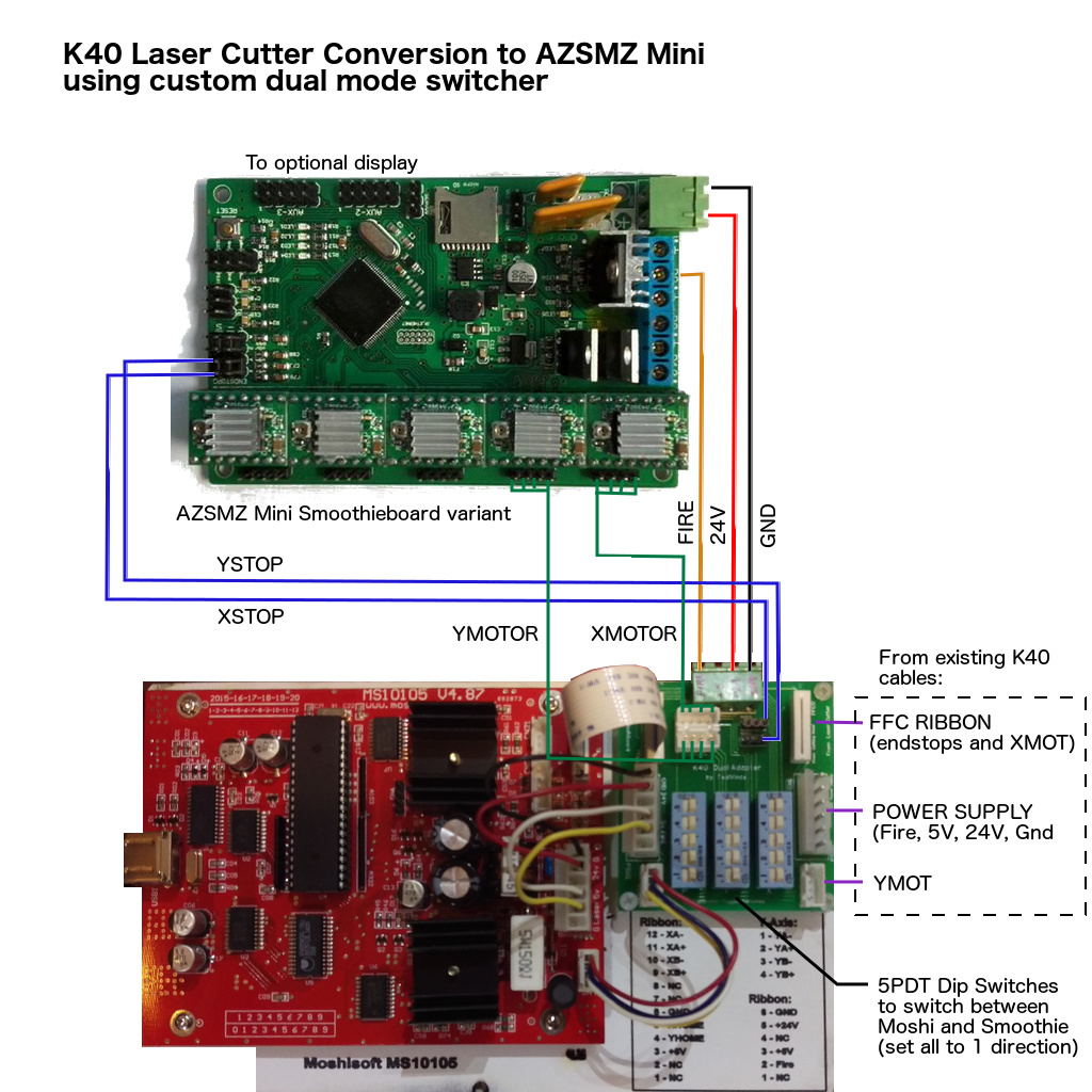

I finished connecting my K40 to an AZSMZ Mini with an adapter board that
I finished connecting my K40 to an AZSMZ Mini with an adapter board that allows switching back to the Moshiboard. As promised, here is a wiring diagram.
I posted up a more complete buildlog and source files at http://makermonkey.blogspot.com/2016/04/hacking-k40-laser-cutter-buildlog.html
I haven’t gotten to the software much yet, as I burnt enough midnight oil this weekend getting this wired up and need to hang with the family ;). So what besides laserweb should I try? I already have inkscape, and have previously exported vectors to Moshidraw. I understand there is a gcode exporter I can use for smoothie.

I probably didn’t need to keep the Moshiboard, but for that matter I’ve gotten pretty used to it and have a lot of existing project files so I didn’t really need to transition to the smoothieboard right now either. But it sounded like a fun project to do, and now I can start using the amoothieboard at my leisure without any risk or pressure to switch to a new work flow right away. It wasn’t that hard to keep both, I figured, so why limit myself when I can maximize my options?
I have been thinking of doing the same. When my Nano board failed, I had a Ramps ready to go, and it did not! I also have an arduino and Gsheild that I put in and played with. Thinking of having both available. I was going to write up my experiences but have not had time. Lets just say it was easier to use the Nano and Corellaser than the alternatives. I have a CNC so it was not a learning curve just a lot of work. LaserWeb was a whole other issue! Learned a lot and will share soon.
@HalfNormal I have a bunch of extra switcher boards. I can send you one if you might find it useful. Originally, I was going to use a panel-mounted switch to change controllers and ordered a big rotary 16pdt Russian military surplus switch to do the job, but decided the corresponding spaghetti in the control compartment would be too much. I really like the double-throw dip switches I ended up using.
