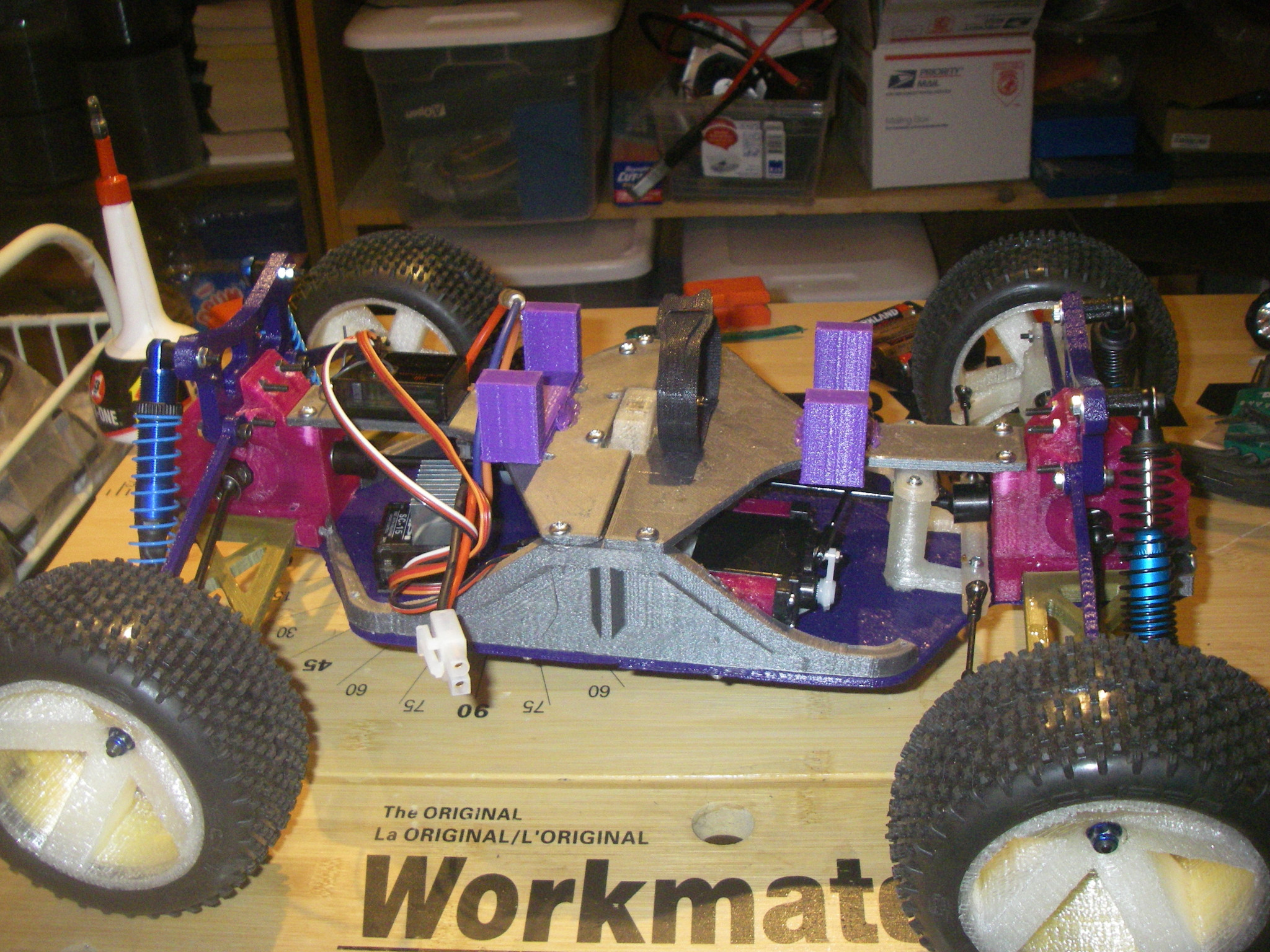

I finished my truggy this week. The last piece was the pinion gear to drive the center differential. I found out the sper gear I ordered was a Mod 1 pitch not a 48 pitch that I thought. The only pinion that the local hobby store had was for a 5mm shaft. The shaft I have is 3mm. I decided to use my old brushed motor. Any way take a look. Thanks again Beerspin/Dan.
Do you have some CAD file for those wheels? They look sweet!
I didn’t make them. They files are at http://www.thingiverse.com/thing:26703 I contacted the guy and he scaled it up to 72mm for me. ( they were 50mm for a street car. I printed them with support at .24mm out of PLA. They are light and strong. I took the car out today and ran it around. It works! Util I hit a curb. Broke the front fork and the front shock tower. No worries I’ll make more. This time I am going to try using the HIPLA. It is supposed to stand up to more shock.
