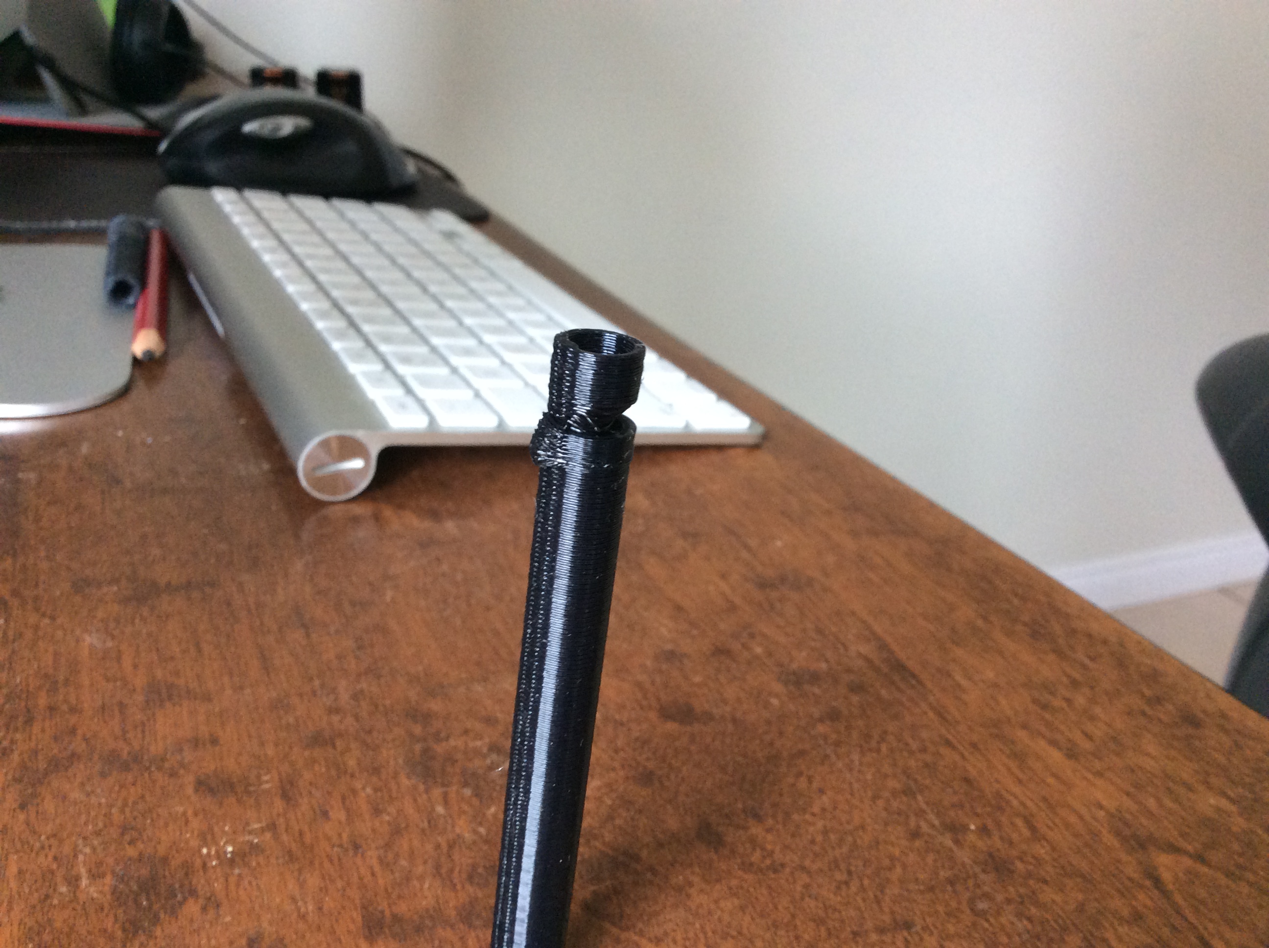

I FIXED IT:) Thank you all for your time :) What was happing was
I FIXED IT:) Thank you all for your time :slight_smile:
What was happing was the Z catching and stopping then letting go.
What is happing? I have been printing for about 9 months I use the tevo tarantula and haven’t had this problem before what happens is when it gets to 80mm it extrudes lots of plastic then there’s a big blob then none comes out then it starts printing normally. Any idea what is happening?
Could also be a partial clog that was cleared.
It has done this multiple times and always at 80mm@shauki
@Adam_Steinmark It has done this multiple times and always at 80mm
Just with this model or any model at 80 mm? A simple test model would be this:
@shauki Ok thanks
@Adam_Steinmark it is any model.
