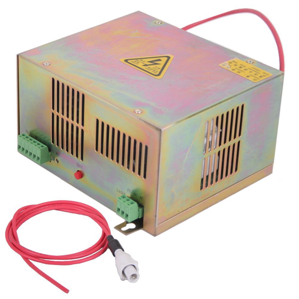

i found a better power supply in the UK Maximum output voltage:DC 25KV.
in the UK
Maximum output current: DC 20mA.
Isolation Withstand voltage: Input-output, input-enclosure: AC2000V-10mA-60s; negative pole of output connected to enclosure.
Protection:with well-grounded enclosure, output circuit of power supply can be open for short time (but arc between positive pole and enclosure should be avoided).
Response time (from time of input being available to the output current being up to nominal value): ≤1ms.
TTL voltage level control: effective voltage level can be high or low through setting.
Protection switch: for detection of cooling water, to protect laser device; or activate with enclosure is opened.
Laser power adjustment: (1) by adjusting the output current of power supply through resistor; (2) through PWM control (magnitude being TTL voltage level)
Environmental requirements:temperature (-10~ 40℃), relative humidity ≤85%.
Input voltage:AC220V or AC110V (to be specified when placing order).
@Hilco_Smit do you actually try it ?
do you find any documentation for it ?
PWM ?
