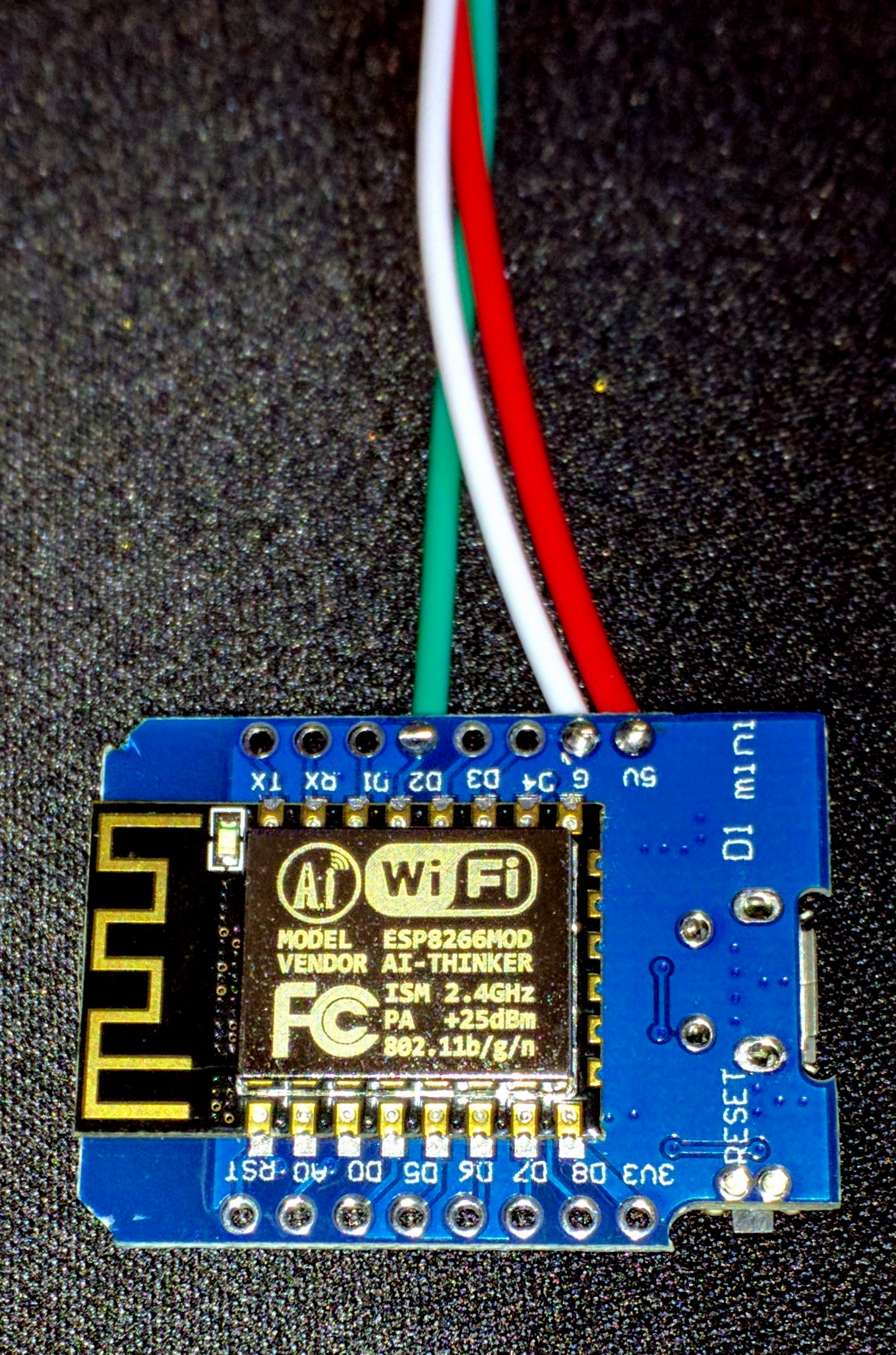

I found these ESP D1 Mini units on Amazon, $6 each.
I found these ESP D1 Mini units on Amazon, $6 each. Perfect for a few LED projects I am working on. The Demo100 ESP web server code is working quite well also.

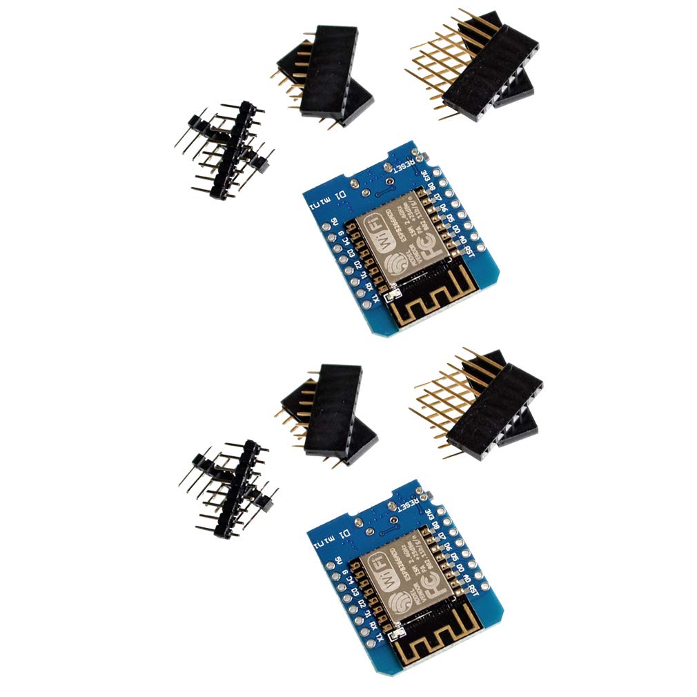

This is what I Purchased

These are $3.90c(AUD) on Aliexpress I order them in batches of 50 for my products. https://www.aliexpress.com/item/ESP8266-NodeMcu-Lua-WIFI-board-D1-mini-version/32727167467.html?spm=2114.13010208.99999999.264.fKIabj they are “clones” but they work perfectly. I have had 1 out of hundreds that arrived with a dodgy LED(but the device still worked perfectly)
