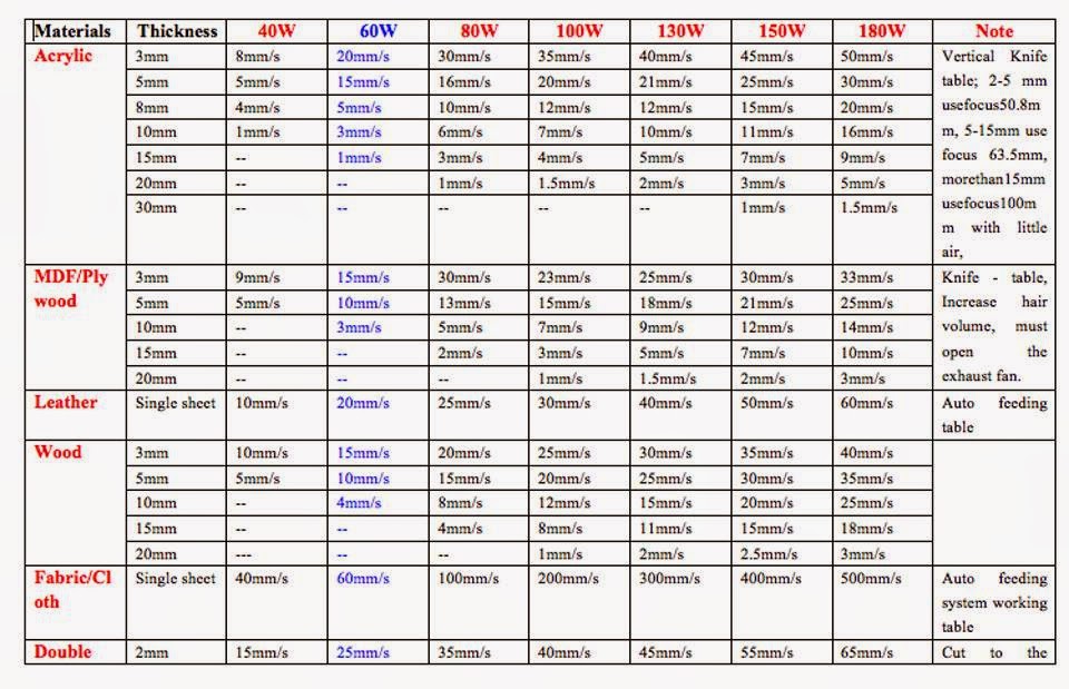

I found this laser settings file and it may be of use to others. Helped me start my own.
interesting note about air (assist):
Acrilic : little air
MDF/Pli increase air volume
