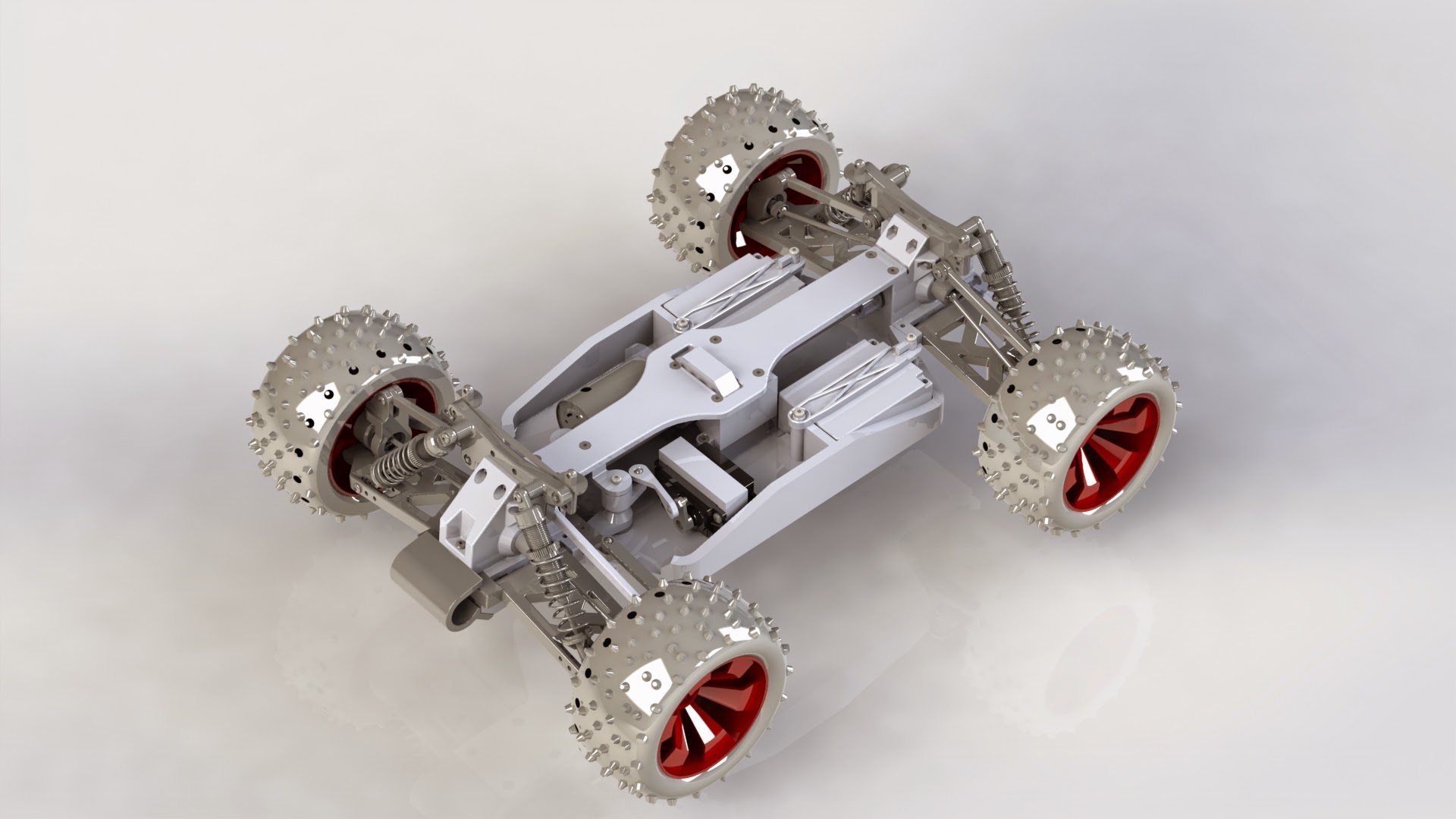

I found this project and was immediately intrigued. Over the past couple weeks I’ve spent about fourty hours going through the design in an effort to make this car the best it can be. I have a RigidBot big printer, which can print up to 16" X 12" X 10" parts, so I made a single piece chassis. I also centered the central differential, flipped the motor around to allow for saddle battery packs and streamlined the servo linkage. I’ve modified all the parts that are a lighter grey in the attached image.
I was planning to buy the metal gears suggested by others that fit this chassis, but am now thinking about finding a better central differential with a slip clutch incorporated, like the one in the team associated B44 buggies. Has anyone tried this yet?
Looks awesome. Have you printed it? File link?
I’ve printed about 1/3 of it - working on the main chassis right now. I’m holding off on publishing it until I’ve tested the new design.
Are you going to publish the .stp of your build? looks great!
Nice idea with the saddlepacks, good job! =)

@Tyson_Messori ​ I race a very high end 4wd buggy and actually eliminated the slipper for a center diff. IMHO you’d be going backwards to incorporate a slipper in this one.
We are also moving away from saddle packs and going with shorty lipo packs. At last that’s the trend in the race world.
Also, be careful about flipping the motor around. The rotational momentum of the motor will significantly change the handling of the vehicle!
