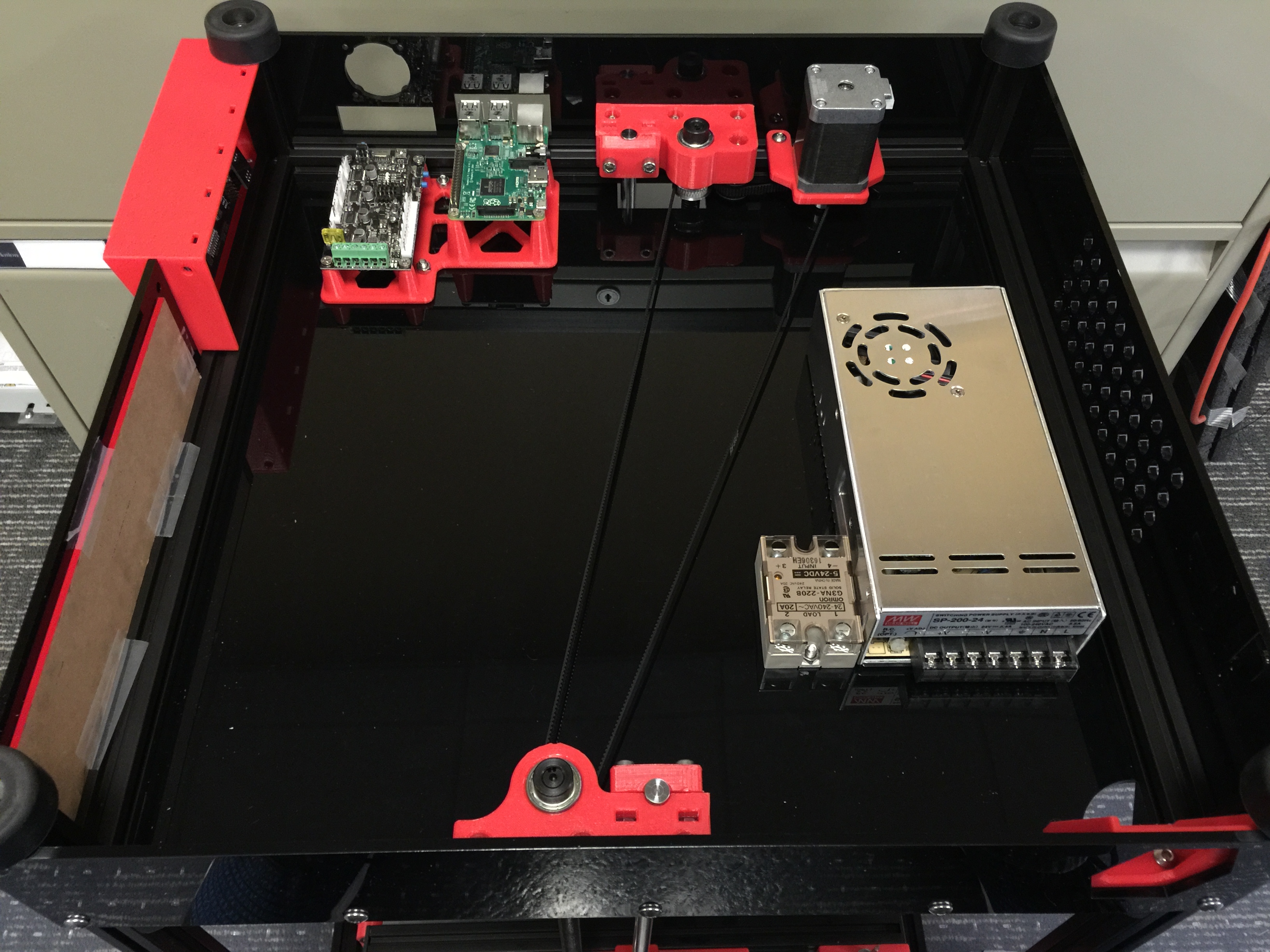

I got everything electrical mounted. What size wiring should I use? Is there a picture or diagram with everything hooked up that I can use for reference?
Wire size is a function of current components will use and length of the run. So what bed wattage did you go with. For the steppers using similar to what you have on the current robotdigg wire leads will work fine. The hotend should be 40watt.

Are you talking about the wiring going from the Azteeg X5 Mini to the stepper motors? Will these leads work that I got from robotdigg?
I did get the 500W heated bed.
I’m mainly concerned about getting the wiring going from the outlet switch to the Relay and Meanwell power supply. If there is a diagram, that would be awesome!!!
The switch has switched and non-switched contacts available. You can tell by using a multi-meter with a continuity test what is what and what goes where as far as the switch goes.
This is for Herculien but the SSR connects the same way: http://i.imgur.com/nmrUim8.png
120V power from the switch/plug in your picture flows through the load side of the SSR, into the bed, out of the bed then back to neutral. The normal bed output on the board connects into the SSR inputs and acts to signal the SSR load contact to open and close.

I think with the X3 wiring diagram, I can manage to get this wired. I will take some pictures once I get it wired and know it works.
