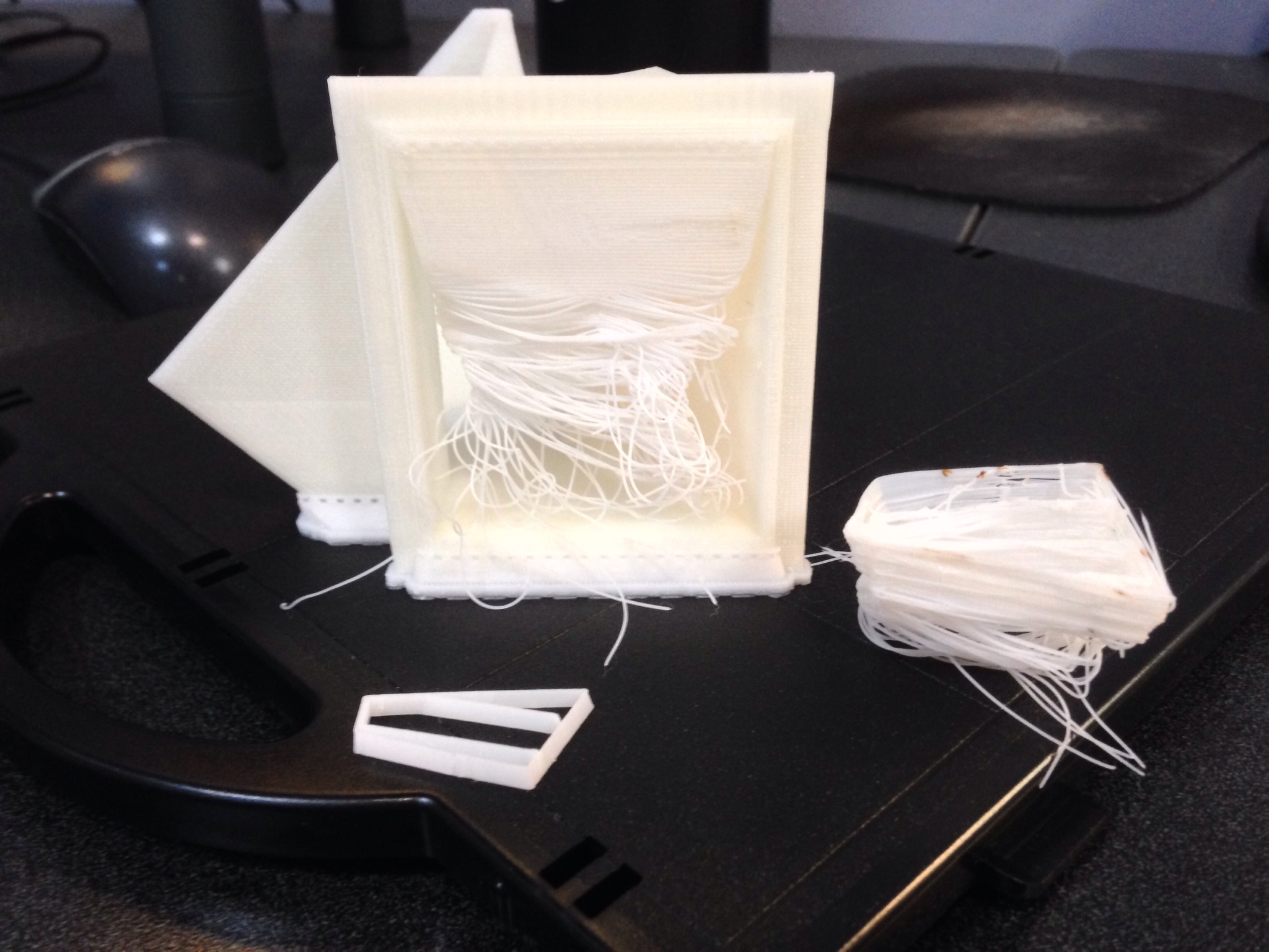

I got lucky with the Stratasys last night. Left it running over night.
I got lucky with the Stratasys last night. Left it running over night. When I woke up I saw a build that walked the line between success and spaghetti. At some point the nozzle knocked the support structure off. Somehow the spaghetti made a recovery though.
Didn’t know stratasys can fail.
Yes, it’s not too common but things get weird with them sometimes. I think one of the z end stops got moved on my machine because I was having a terrible time getting the parts to stick to the platform. Luckily I found the software used by technicians to service and troubleshoot the machines. With that I was able to adjust the home position of the platform without trying to manually move the end stop .020"
It is very picky about how much the filament swells in the barrel. I completely gave up on using a roll from Inventables. Although that particular filament was one I was having a difficult time with in my RepRap’s PEEk barrel. I don’t want to knock it too much but that roll seems to have a lot of volatiles, and maybe mineral oil, in it as well.
Some of the material I’m using is not OEM so there is that argument. But at the end of the day it shouldn’t be the cause of the support material getting knocked off.
