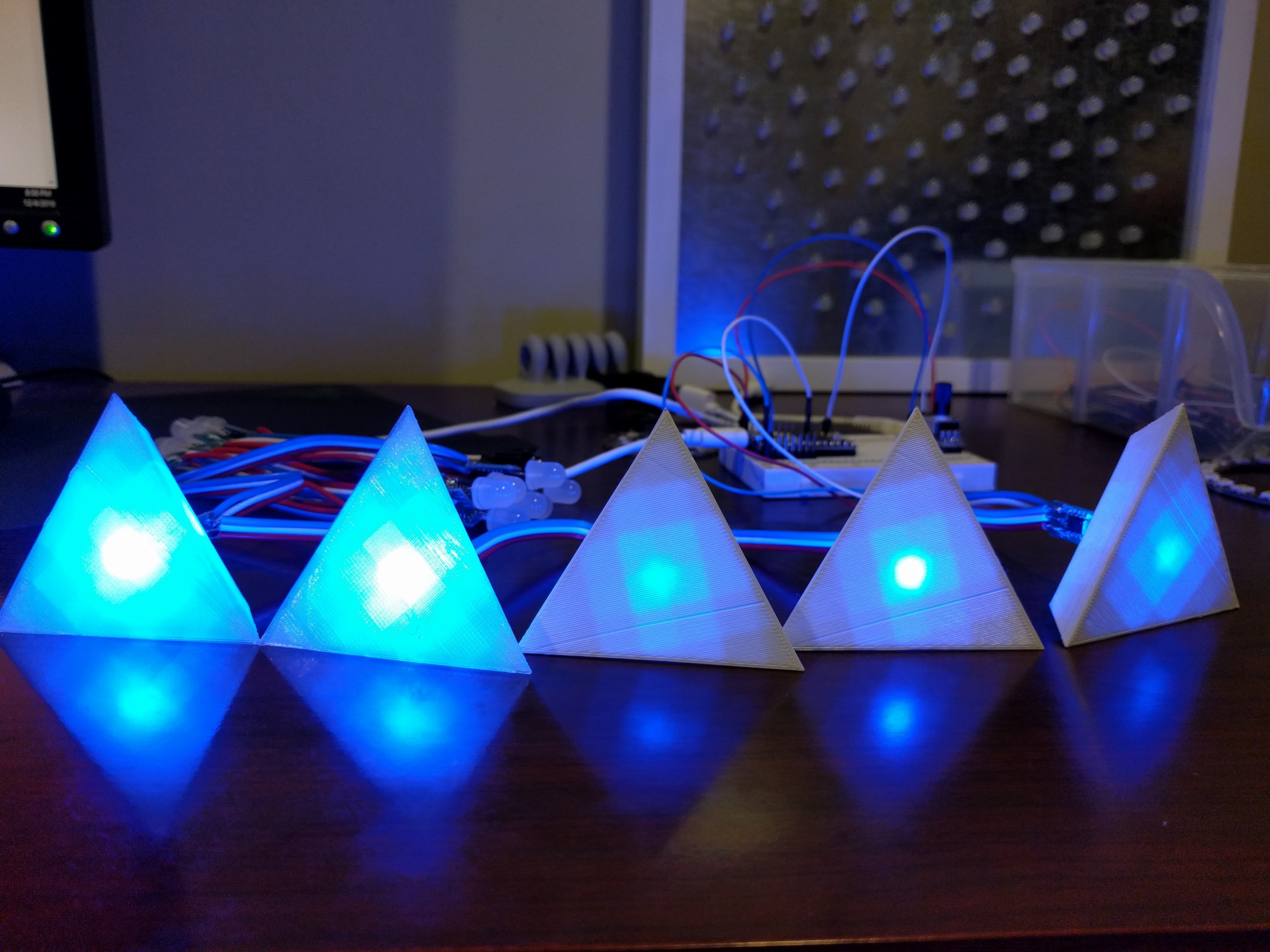

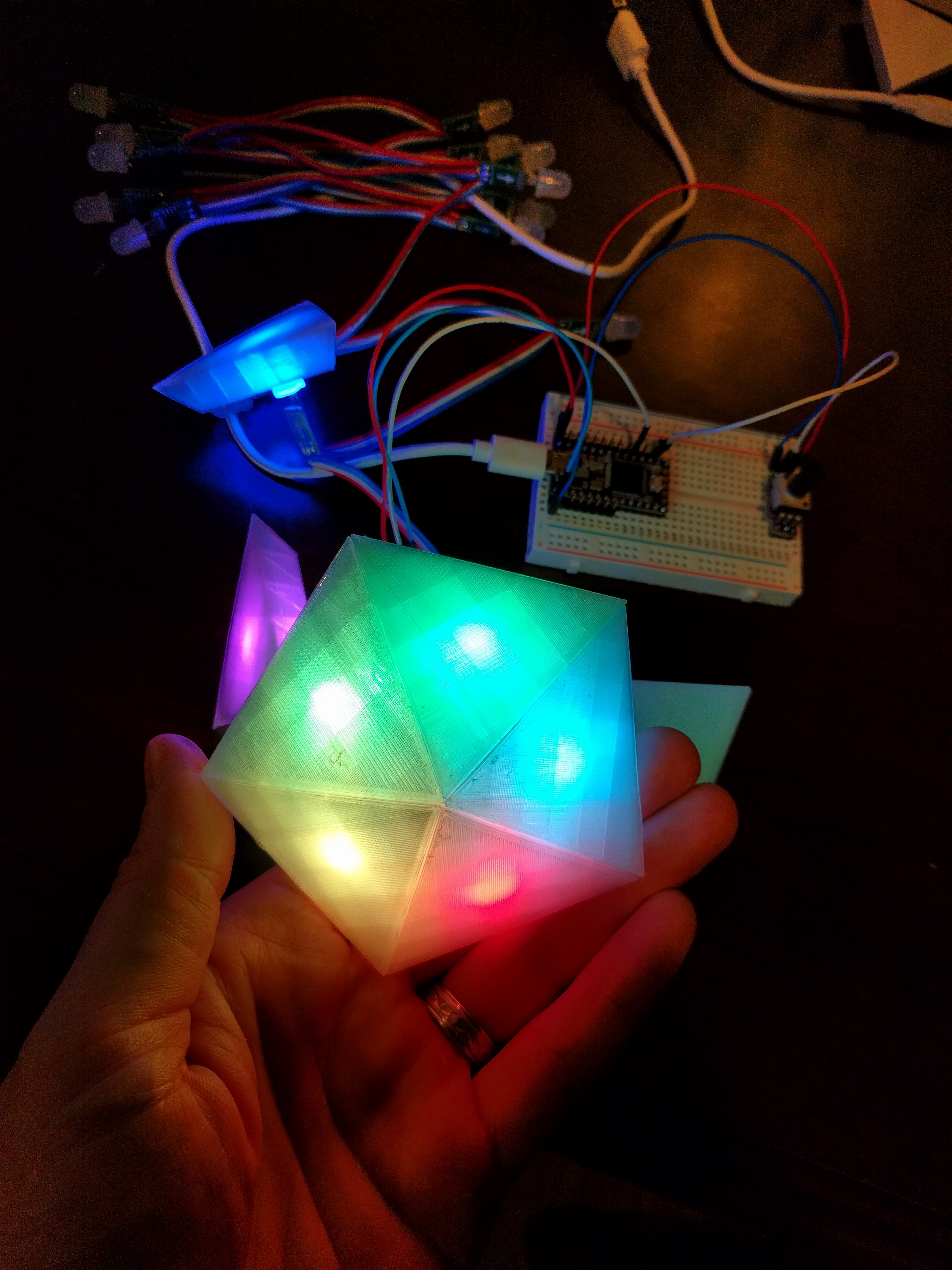

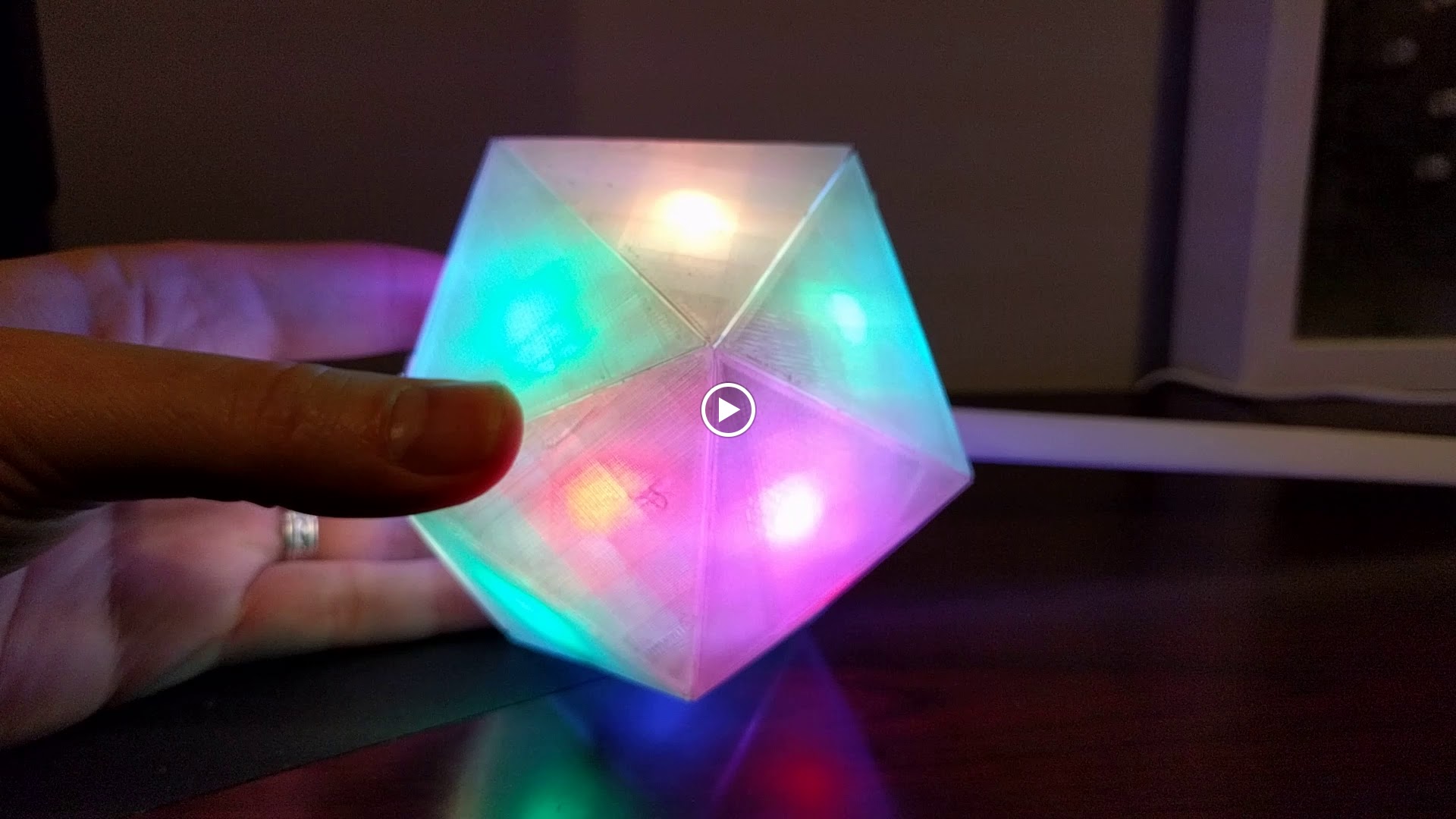

I’ve kept it busy printing custom little LED sculptures. :slight_smile: More pics and videos: https://photos.google.com/share/AF1QipPYO2Vz3eNDLhke7L4McUv0Kk11wt5bCbq56O14wW_r0DcrMpPyApLYGsPH9G6NFA?key=bjgxcDczYlYtVGhnX01uTTJKZS1qYkpWazlaQlRB
Is this your first 3D printer? Just thinking these could really benefit from a quick acetone vapor bath for a smooth, glossy finish.

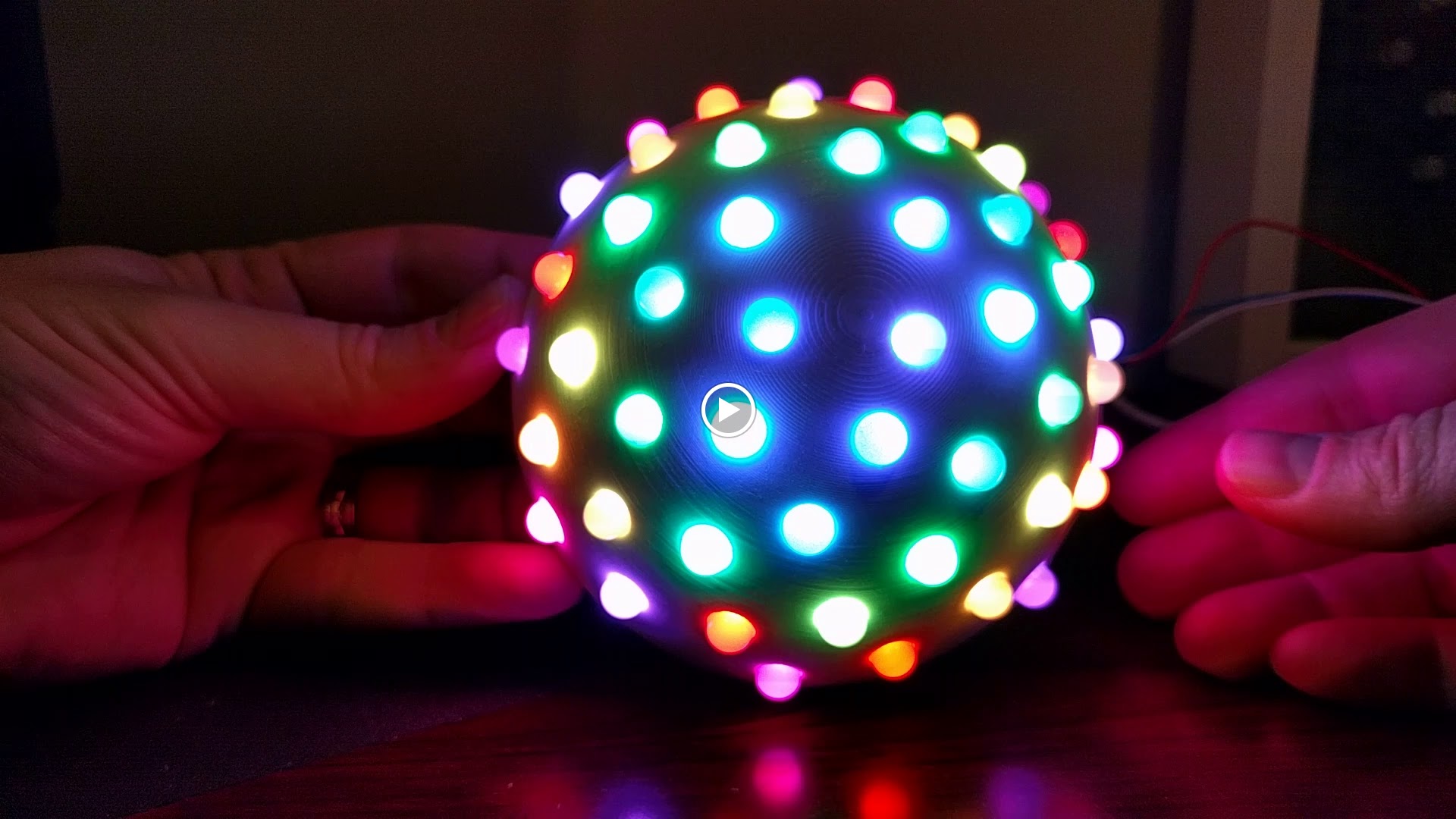

Yeah, it’s my first 3D printer, and I’m a total noob at it. :slight_smile: I sanded the Fibonacci hemisphere a bit, but it’s still rough. It’s PLA, so acetone won’t work on it, will it? I thought about trying XTC-3D.

I love the light ball !!
Awesome projects as always. Excited to see what else you come up with. I have really been interested in getting one but was concerned about the light diffusion. Looks like you get some striation? I have a buddy that just showed me how you can make silicone molds from the 3d arts and then create cased silicone molds of the pieces to smooth them out, make them flexible and control the light diffusion!

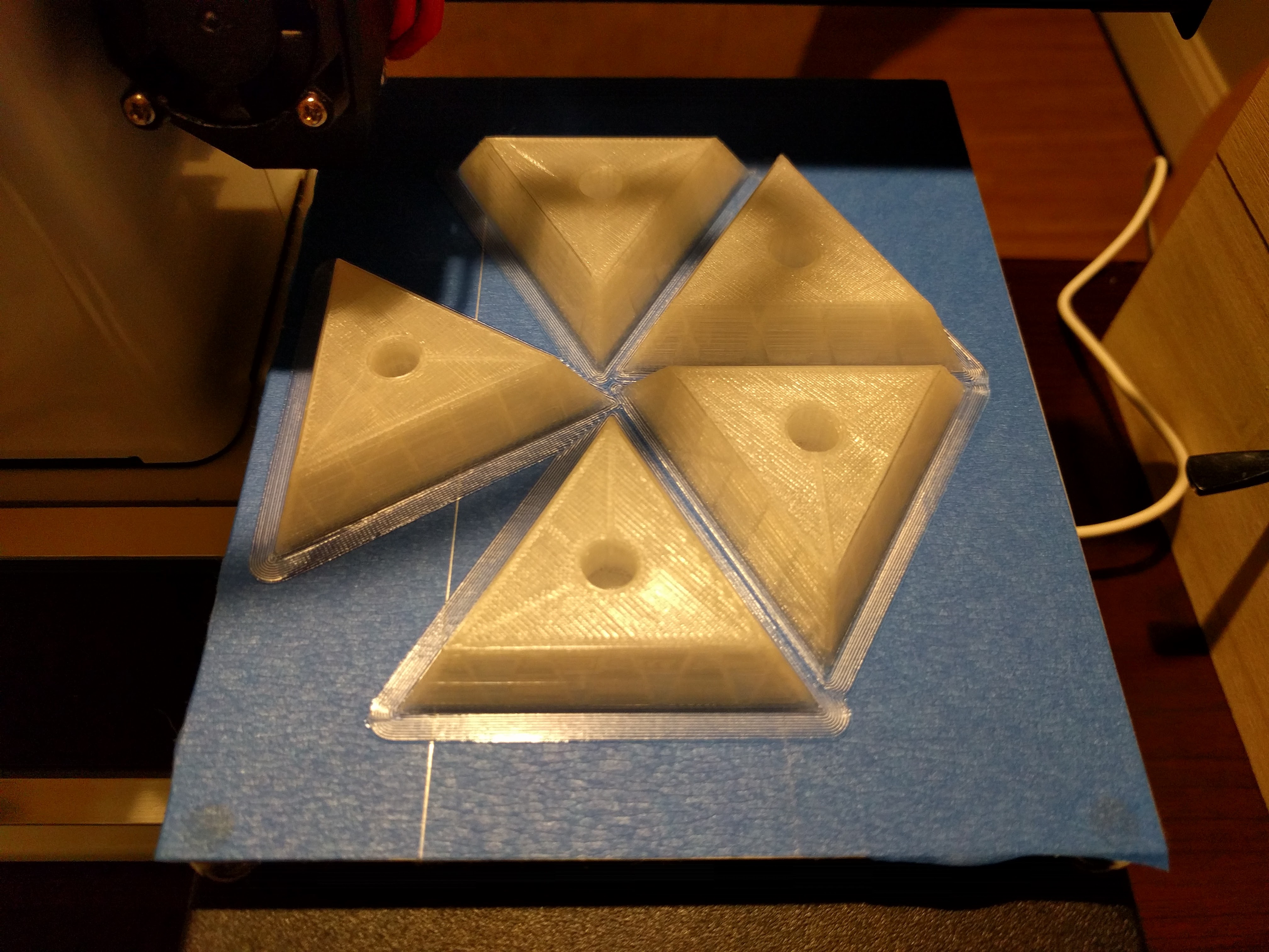

Thanks for the feedback and tips, everyone! I still have a lot to learn. The “natural” PLA I bought is very nicely translucent. I’m working on improving my first layer, which I think is what’s causing some of the striation issues. Also, the translucency allows you to see the infill (internal support structure). I’m working on using different infill patterns to improve the look. I definitely should have spent more time sanding on them, will definitely try that next time.
