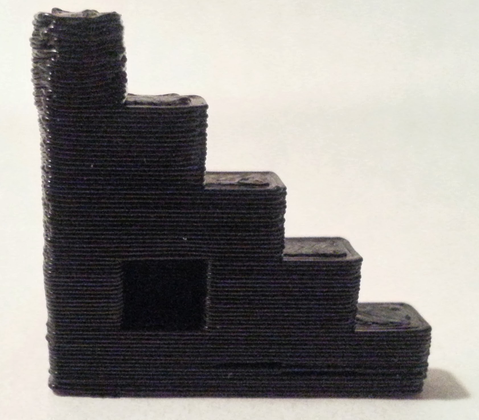

I got my PB-Simple dialed in much better,
I got my PB-Simple dialed in much better, thanks to your comments. This is 0.3mm layers, PLA, fan on, 185C, 25% infill, 3 shells.
I seem to have clogged my extruder because, when I tried a bigger print, the motor just clicks without pushing the filament. I couldn’t push it by hand, either. I’ve taken it apart and cleaned the entire path the best I can (filament moves through it cold, and I can see light through the tip). I’m going to up the temp to 190C for my next try (tomorrow; too late tonight).
You also look to be overextruding a bit. You’ll want to probably turn your e-steps-per-mm down a little.

Definitely over extruding. Your top layers are too hot, causing deformations too. You need a delay or print slowing or a stronger cooling fan.

All: You guys are a great help! I followed the tutorial @Tim_Rastall linked (my filament is a consistent 1.85mm!), and calibrated my extruder rate as suggested by @ThantiK and @Stephanie_A (yup, ~6% too high). Between the two, I was over-extruding by ~12%!
New calibration step printing now and looking good. I think I need to drop the temp a couple of degrees, and maybe change the retraction from 1mm to 2mm since I’m getting just a little stringing.
