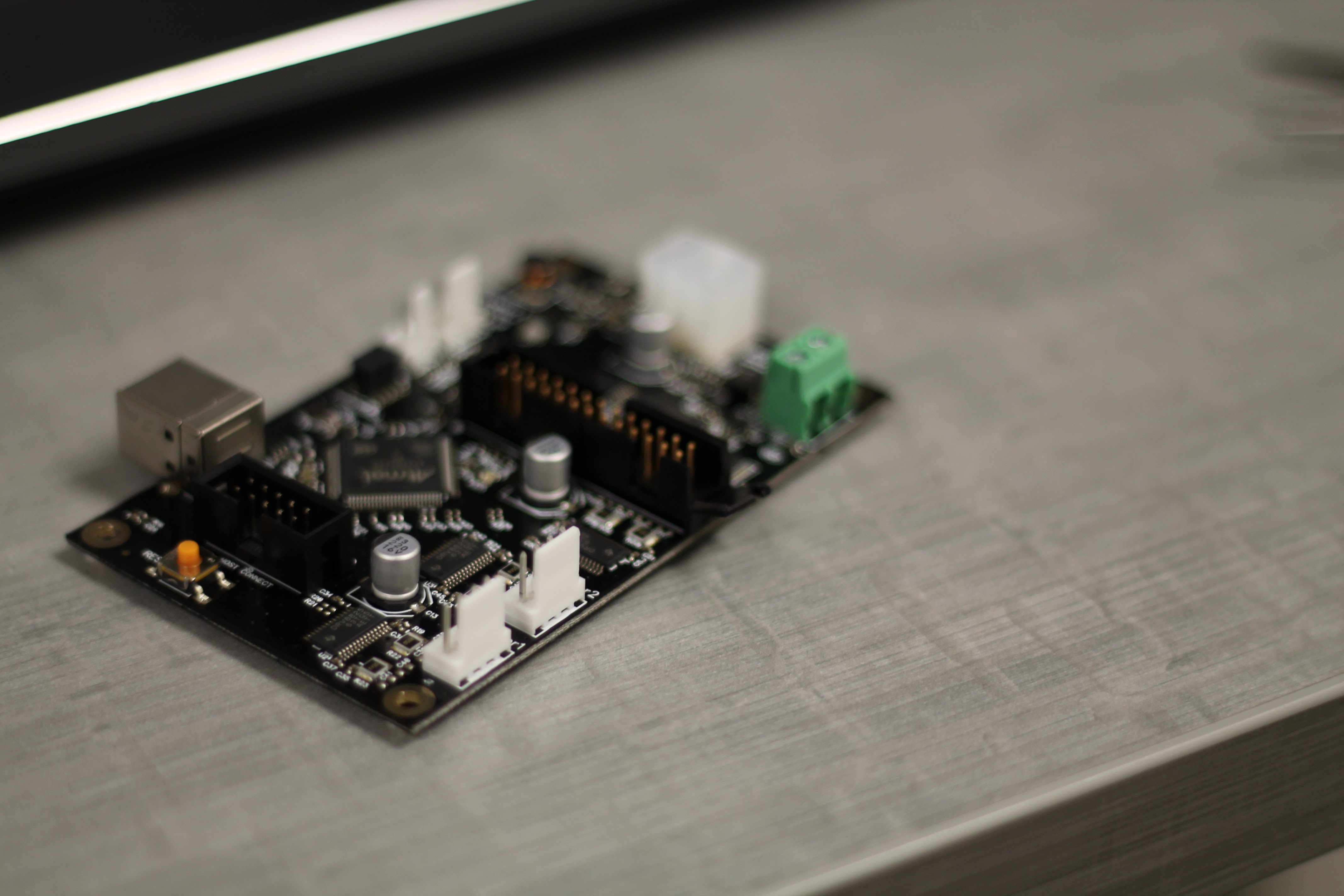

I got the new Printrboard G2 installed on my 2013 Simple Metal today. The pictures aren’t very clear, but I had to cut away at the edge of the header shroud on the board because it was colliding with a rivet in the frame. Just a heads up if someone else is trying this.

@Matthew_Del_Rosso Well back when I decided to buy it, the G2 looked like it would have Trinamic stepper drivers on it, which would mean nearly silent stepper motor operation. Unfortunately that appears to have changed, and the G2 now ships with Ti’s DRV8825 drivers, which are just as loud as anything as far as I can tell.
Otherwise the G2 appears to support some fancy features (instant stop command execution!) and nicer motor control. I think the real benefit will be felt by people who just get the new 2016 printrbot and have the cloud integration, but I’m interested to see what the G2 has to offer outside of that.

Synthetos (maker of TinyG and G2) isn’t the same company as Printrbot. Makes sense to me that they would call it a Printerboard instead of using the Printr branding.
@Ryan_Carlyle I thought the new printrboard g2 was still designed by Printrbot though, and just used the g2core firmware?
If Synthetos made the board then the discrepancy makes sense, but it still sounds odd.
@Chris_Bero board was designed by Alden from synthetos for printrbot. Printrbot is manufacturing these boards in their factory in Lincoln. That writing on the board was just an oversight. Board is officially called printrboard g2
Silkscreen error? Gotcha
@Mick_Balaban Cool, thanks!

@shannon_greim G2 doesn’t have an sd slot, and the retrofit doesn’t come with a wireless antenna from what I can tell.
Octoprint doesn’t work with it because the G2 uses JSON not gcode, I doubt pronterface does either.
I was using chillipeppr to process gcode and send the JSON to a Pi with the G2 connected.
