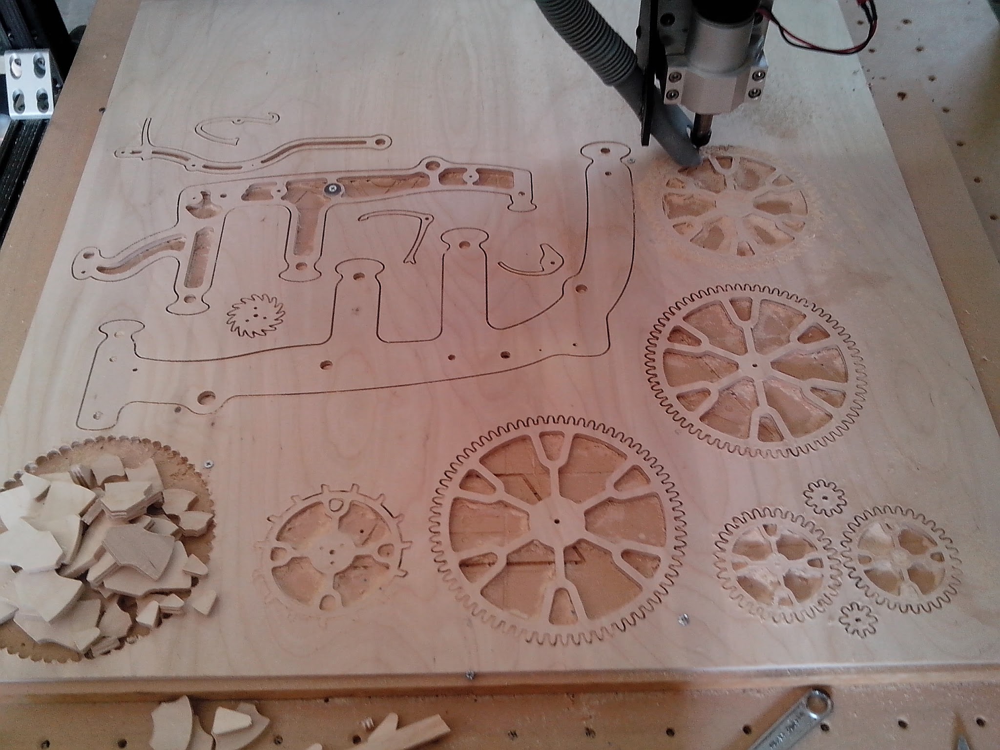

I got to spend some quality time with the CNC router today. The picture shows about half of the parts necessary to build Brian Law’s Clock 22. I finally have a working setup that is easy to use! This is mainly because of the new CAM-BAM software that somebody recommended. I highly recommed it for DXF to G-Code conversion. Especially for routers like this one that run LinuxCNC. It is super easy to use and easy to insert the holding taps that keep the part from lifting up after it is finished.

Some parts on this clock needed a 2mm bit, so I decided to use a 1.58mm diameter bit for the whole thing. I cut at 800mm / minute and 1mm depth for each pass.
800mm/min with a 1.58mm bit, that’s pretty fast. Is the bit Carbide or plain HSS. What RPM, number of flutes etc…

Henrik, 800mm/min doesn’t seem so fast when it does 7 passes to cut the part. I typically don’t cut faster than about 1300mm/min with a 1/8" bit. The chips that are generated are micro-fine saw dust, so I actually need to turn down my RPM a little to get the right feed rate for maximum bit life. I don’t know what RPM it is running at. It is a 24V 400W motor running at 3/4 throttle. The bits are 2 flute carbide that I got from Ebay for about $2 each.

Just out of curiosity and interest, I have been looking up the parameters for your job, and with the parameters I have now, but guessing the remaining tool sizes and just using Modelling board (under plastics), i get a feed of approx. 335 on optimal conditions and 20000 RPM. Setting feed to 240% is 800 mm/min, still within tool safety.
The interesting thing is that even at 300% feed, the torgue is still near 0 Newton, which is good.
You could try calculate yourself using http://zero-divide.net/?page=fswizard
Experimenting with the values, shows that you should be able to cut at full depth but slower, but still overall faster than current job conditions. But thats up to you to try. If you do try, please let me know how it turns out. It’s also important how the cut item finish is.

With a small bit like this one, I prefer not to load it too much for fear of breaking it. Cutting the 7mm depth in one pass is tempting, but I prefer to take it more conservatively. The problem I had in the past with moving slower during a cut is that the wood tends to warm up and discolor due to the friction. Cutting wood is not as predictable as plastic. With ABS all the chips are identical to each other and the bits seem to go through it like butter. With wood there is different densities and if I load the tool too much, it could bounce around. Having a super accurate machine should keep that from happening but for most of us that is unrealistic. That is why I prefer to move fast and keep the load down by doing shallow passes (1mm). So far I have had good luck with not having very much of the top layer of ply lift up. There are a couple places where some gear teeth lost a little on the edge, but overall I am pleased with the results.
