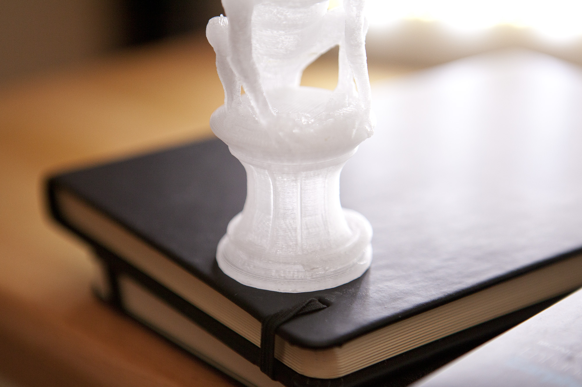

I guess i just had to join in! Printed 200mm tall with Tritan.
Design by @Louise_Driggers : https://www.youmagine.com/designs/aria-the-dragon
Infil? (Wished I’d added a few more perimeters too hide the Infil in the wings)
@Mike_Miller zero - the awesome modeling work makes that possible! 1mm (side) and 1.5mm (top) shell, 0.25mm layers, Cura.

@Ben_Van_Den_Broeck ​ i got the overall best results when printing it almost like ABS, just slower. That means 35mm/s, a 120C (110C) heated bed with PET tape, 290C (275C) hotend and relatively thick layers. It took me a while to figure out how it likes to be treated, but it now prints super reliable and is insanely good with overhangs. But I still need to see how I can get the layers to stick a bit better without cooking the plastic too much. I will eventually make a full guide/review, but, as always, I want to be confident that I’ve got it completely figured it out.
first layer temp (consecutive layer temp)
