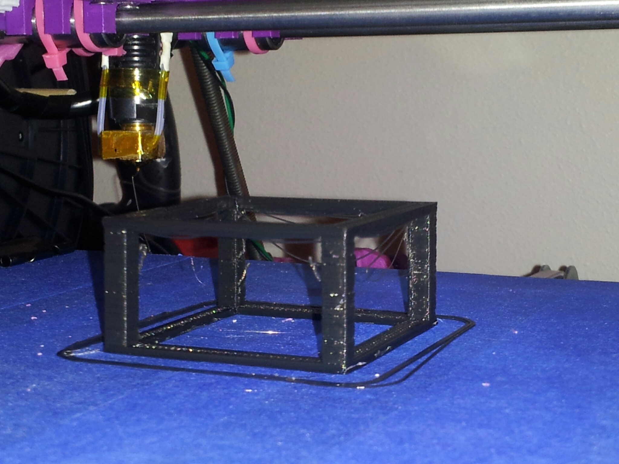

I guess my prints are sticking a little to well,
I guess my prints are sticking a little to well, lol
