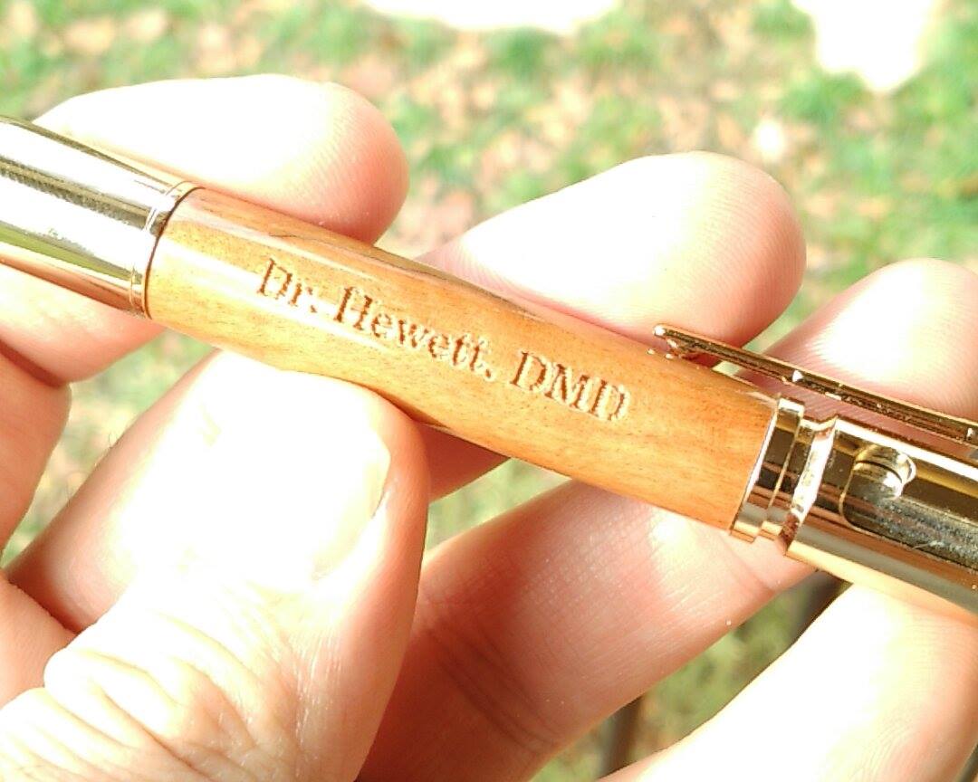

I had a customer send me a pen for engraving. My question is, if I decrease the beam diameter, I can eliminate some of those ridges correct? Right now I’m set at 0.15 but I’m thinking I should to back to 0.1 or 0.099 since .1 yells at you to set your beam diameter constantly…or used to anyway.
I use .1 and .09 for many tasks that require fine detail… just remember there will be more beam overlap so adjust your power down just a tad
