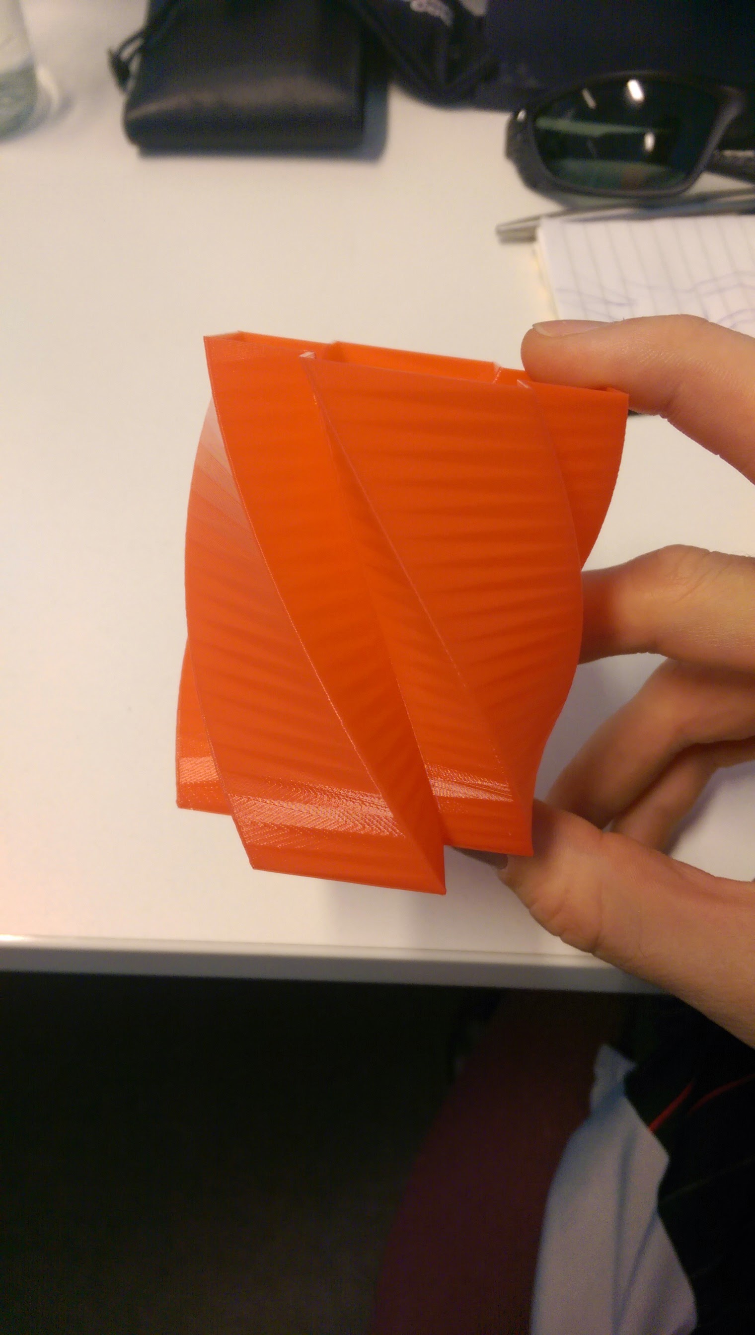

I had been having a tough time trying everything I could to get some
I had been having a tough time trying everything I could to get some new PLA to print anything without jamming up or just being really average, then I came across a tip (of course it’s likely common knowledge and I’m behind the curve as usual…) - a cloth wiping a little canola oil on the filament before it gets extruded instantly solved everything, and I really can’t believe how well everything is coming out now.
Once again, lubricant solves everything :wink:
Nice prints, verry shinny. What setting have you used? :slight_smile:

These are on my Bukobot v2, .20 layers with around 30 seconds min layer time (the spirals are 2-wall vases) at 210° onto cold glass.
The spirals are a dead simple openscad object, I’ll post in shortly when I get home. Other little guy is https://www.thingiverse.com/thing:23483

Easy-as spiral - http://www.thingiverse.com/thing:548898
