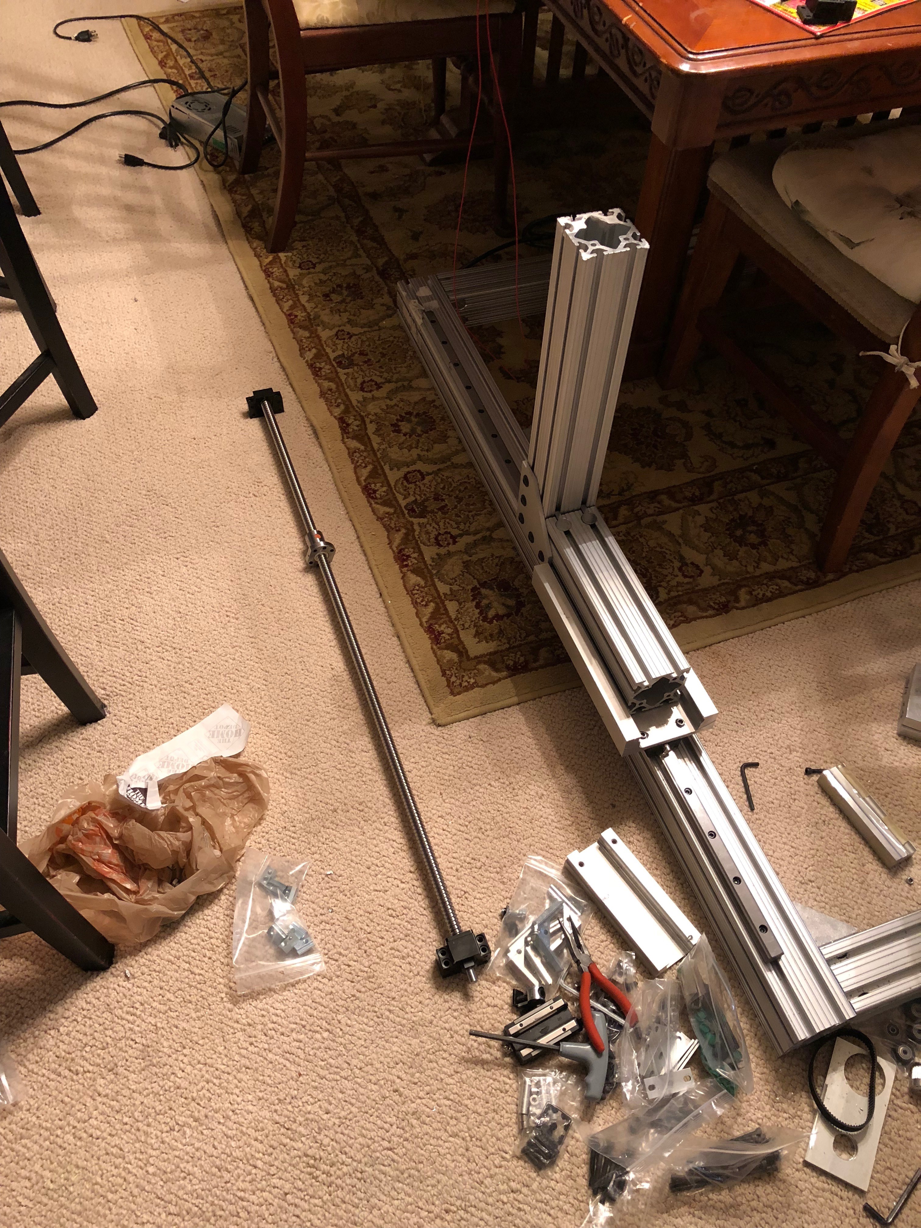

I had to repack a ballscrew after the machinist removed it, lost some of the balls and couldn’t replace it…Not a fun/easy activity! Actually ordered another ballscrew nut to replace the old one, but ended up just using the ballbearing balls to replace the missing ones on old nut. Future advice: don’t get parts machined…the cost to have this machined was more than I paid for the part itself…by double! And it still left me having to repair the nut!
I completely agree with that. Spend extra and get it right the first time, I had the same ordeal happen. I ordered a new short ball screw with the nut on. Also a mistake, because I lost some balls, and replaced them with the new one. Not even sure I got enough in, but it still worked fine…
Great progress by the way!
@Mark_Leino Thanks. Finally getting to the backend of the frame building. Then comes the electronics, wiring/over current protection and setting up the control box. I’ve built an Ox before, but I didn’t have a VFD, external drivers, the type of spindle I have for this one (which is also water-cooled). I also didn’t set up the limit switches. I have a different controller for this CNC, which is a Mach 3 system (smooth stepper). So, I still have a lot ahead.
