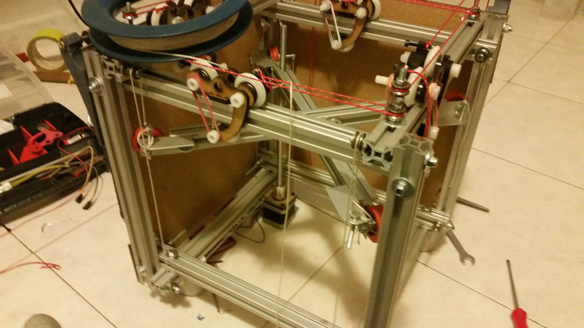

I have 1mm kite dyneema cord for Z are good too..
I have 1mm kite dyneema cord for Z are good too… on “pulley” work but risks to fall inside and lose step… finaly my Z stay completely planar without any more weight possible on 500 version pp cord are good too…dyneema cost 10 euro for one full qr…Vs 6 euro of 100mt of common pp cord real different price but dyneema permit more print quality…as we see @shauki ​ change with black cord we qr’s is a dyneema
Please note: Dyneema cannot work in heathed box. The max. temp are 60-70°C.
Max…sorry but this time have opposit point of view . because gt2 max temp work are 85° and makerbot and other printer used inside box with motor… my round belt ambient work max 65° (people give me used it used near owen at 100° without issue for years)…want try after ask it and on dyneema spec ask it can work for “short” (without time range) at 145°C too… ok is a cord simple to change :slight_smile:
