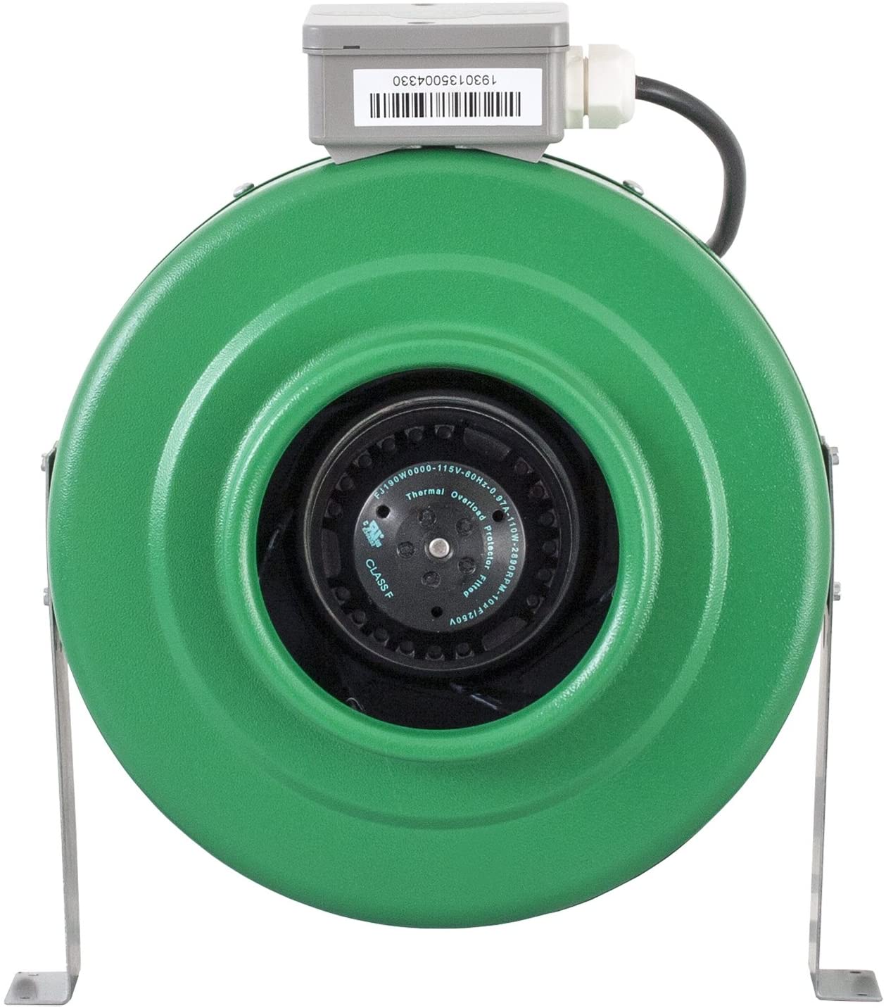

Any suggestions? Or do I have to bite the bullet and buy something like an Inline Fan?
